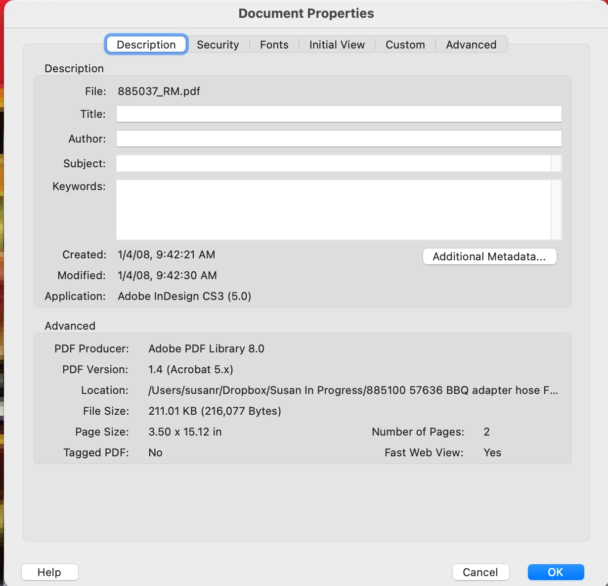

PDF is a final delivery format, and is not intended for major editing. Someone in your company should have the original work files for these technical manuals - they may have been done in InDesign, but there is a chance that they were done in some other program, such as Microsoft Word. If you open the PDF in Acrobat and look under File > Properties at the Description tab, it should show what program the PDF was generated from.
(In this example, it was Adobe InDesign CS3)
