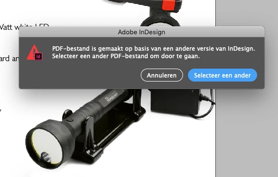

By trying out the new option "import Pdf remarks" an error appears which forbid to import the remarks of the pdf file via a customer.
Message:
This pdf file is made with an older version of Indesign. Select an other PDF document to go on.
This means that I have to rewrite all the older pdf files which where made with an older version of Indesign?
Or did I missed some information why this is happing.
Maybe somebody else also had this problem and help me out
Thanks in advance

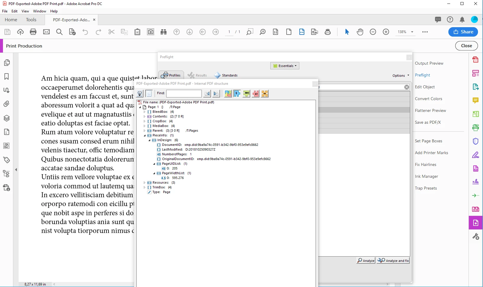

InDesign CC 2019 is exporting special comments to a PDF when exported.
So called PieceInfo. This is required to identify specific stories and other things:
You can inspect the PieceInfo with Acrobat Pro DC.
Go to Print Production > Preflight > Options > Browse Internal PDF structure…
To rely on special PieceInfo that is written to a PDF is the backbone of the feature.
A design decision that was made just from starting to build InDesign's PDF Comments feature, I guess.
Uwe

Ah, the PieceInfo is new. But no, that cannot be the reason this only works with freshly exported documents.
The information in there might be useful for something else but it cannot be for use with Annotations. If you add an annotation to a piece of text in Acrobat (or with any other software), there still is no connection between that annotation and this new PieceInfo. Other software cannot create such a link either -- it would not know what to do with that PieceInfo! So there is still no link of any kind between any random annotation and the physical text in InDesign, other than its x/y position.
(Straying off-topic but perhaps Adobe is planning to allow opening such a PDF into InDesign again. Now that requires additional metadata of this kind.)
