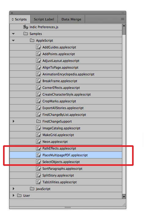

    You can import the file into InDesign but you will not be able to edit it there. You could recreate the layout in InDesign and depending on whether the text in the pdf was originally an image or if it was created from live text you should be able to copy and paste text from the pdf into your new layout. It is also possible to do some editing in the pdf itself using the latest versions of Acrobat but I have had only limited success doing that because of font issues and I would not recommend it.
    If your goal is just to import a multi-page pdf into a new InDesign file you can do that using a script that comes with recent versions of InDesign. Create an InDesign file to the size of the pages in your pdf with margins of 0. In the open file go under the Windows Menu to Utilities and choose Scripts. The Scripts Panel will look like the screen shot below:
    Under Samples>Applescript choose PlaceMultiplePDF.applescript and double-click. You will then get a navigation window and use it to find the pdf you want. It will ask you what page you want to begin and say page 1. If, as I said before, your pdf is the correct size all of the pages will pop into place.
