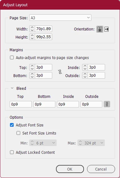

In the InDesign File menu, you'll see "Adjust Layout." You're not changing the geometry, just scaling, so this is basically a one-click solution. Be sure to check the box that says "Adjust font size":

I am reluctant to recommend Adjust Layout, especially to what seem to be less than expert users. It's just one of those features that doesn't work as well as it should — that is, it works fine some part of the time, and makes a difficult mess the rest of the time.
However, A-size to A-size adjustment, which is entirely a scaling issue, is almost certainly right in its tech-demo wheelhouse. 🙂

That was my thought, although I have to say that Adjust Layout was superior to Alternate Layout and Liquid Layout even in beta. When we were originally testing it, I was impressed by how quick and easy it was to use. It breaks down when the aspect ratio changes too much, especially switching between landscape and portrait. Never did much testing on that, because at the time it looked too broken to be worth exploring. I've rarely had an occasion to use it in real work projects.
