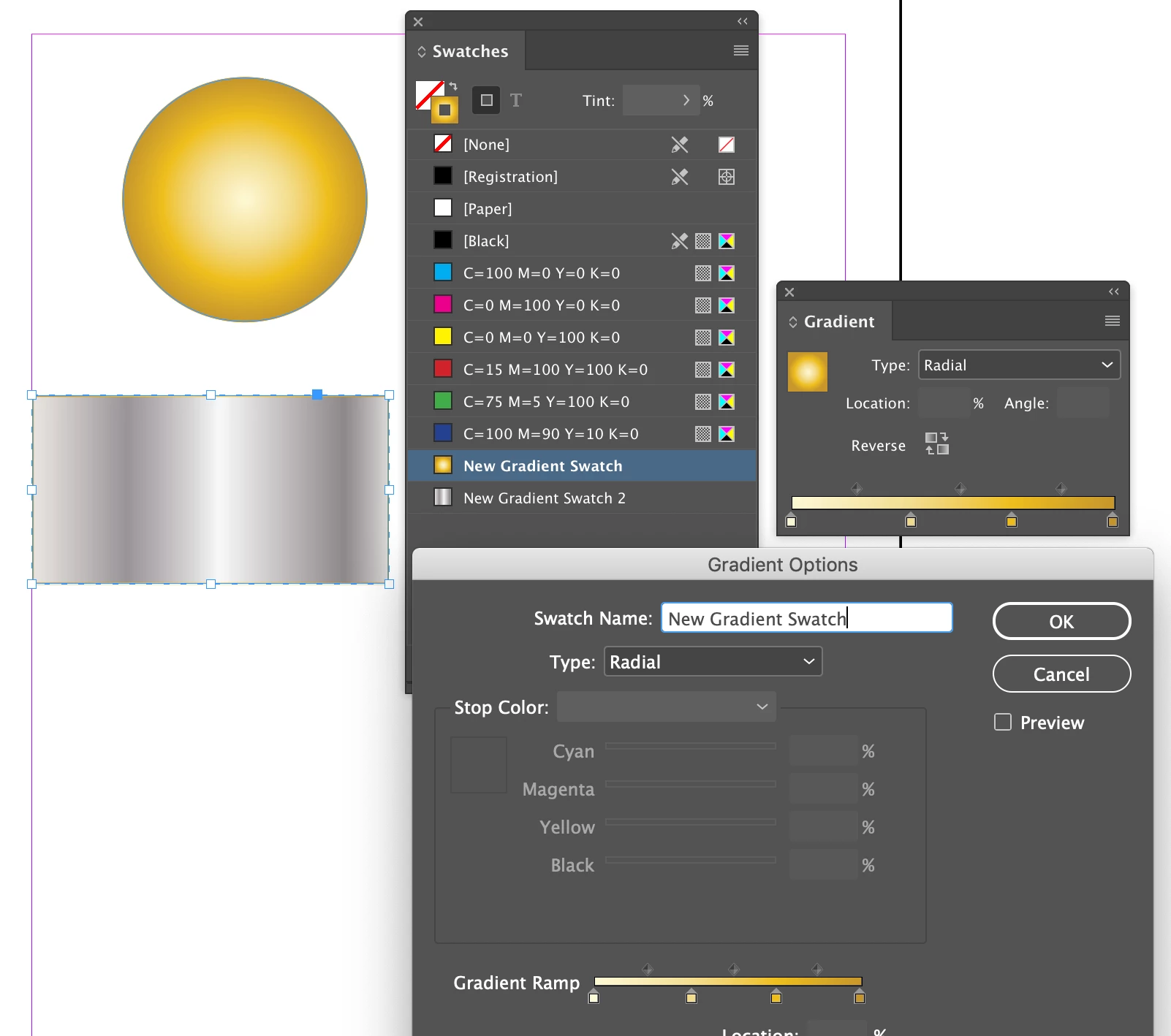

I'm a Steve. I work on a Mac with macOS 10.14.3, InDesign CC 2019 and Illustrator CC 2019.
I would agree with Uwe's description of when you can copy gradients from Illustrator to InDesign and I have have no problems with doing that (two examples shown below—one radial, one linear).
