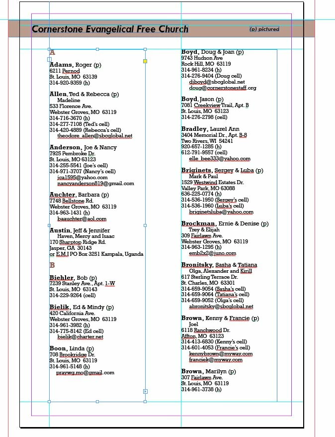

Thanks for all of the replies and the links to plug-ins, etc.  However, being a bit stubborn, as we have done this task before in INDD cs6, we are flustered to recall exactly how we did this, therefore trying to find a solution.
Please see shapshot attached for the layout we have previously done, with the linked/threaded text boxes.
Just seems we are missing a step in the process to get this accomplished.  We get the data into indd, but will only show the first of the list in the text box.  We can click on the preview and it will flow through each contact individually in the same box, but just unable to get all to flow through.
Additional ideas or solutions are appreciated.
BobLevine
January 13, 2017
If you can't remember how you did it, how do you know it was a data merge?

Colin Flashman
January 13, 2017
InDesign's Data Merge feature can't data merge multiple records into the one text frame like you describe in your opening post. I've written a comprehensive list of what the multiple record feature can/cannot do here: https://colecandoo.com/2013/12/28/data-merge-multiple-record-madness/
You can perhaps try one of the various plug-ins for InDesign that are intended for catalogues as they should be able to handle this task, or a lower-tech option that uses a javascript to take a data merge file and recombine it into one massive textframe. The downside to the script is that once the script is run, the data is no longer live, so if a change is made to the database, the whole thing has to be done again. The script is available here: Downloads | Ozalto  and it is the inlinemerge script.
If the answer wasn't in my post, perhaps it might be on my blog at colecandoo!
