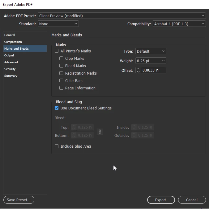

Are you including printer's marks in the export? They add to the PDF size.
If you are you will also need to increast the marks offest to at least the value of the bleed allowance to keep them out of the bleed area, which will increase the size even more.

Hi Peter, thanks for that! There are no printers marks (they asked me not to).
Just now a TON of white space around the art and 6.2x4.2.
I may be a lost cause! 🙂

Did you run your artwork out to the bleed guides?

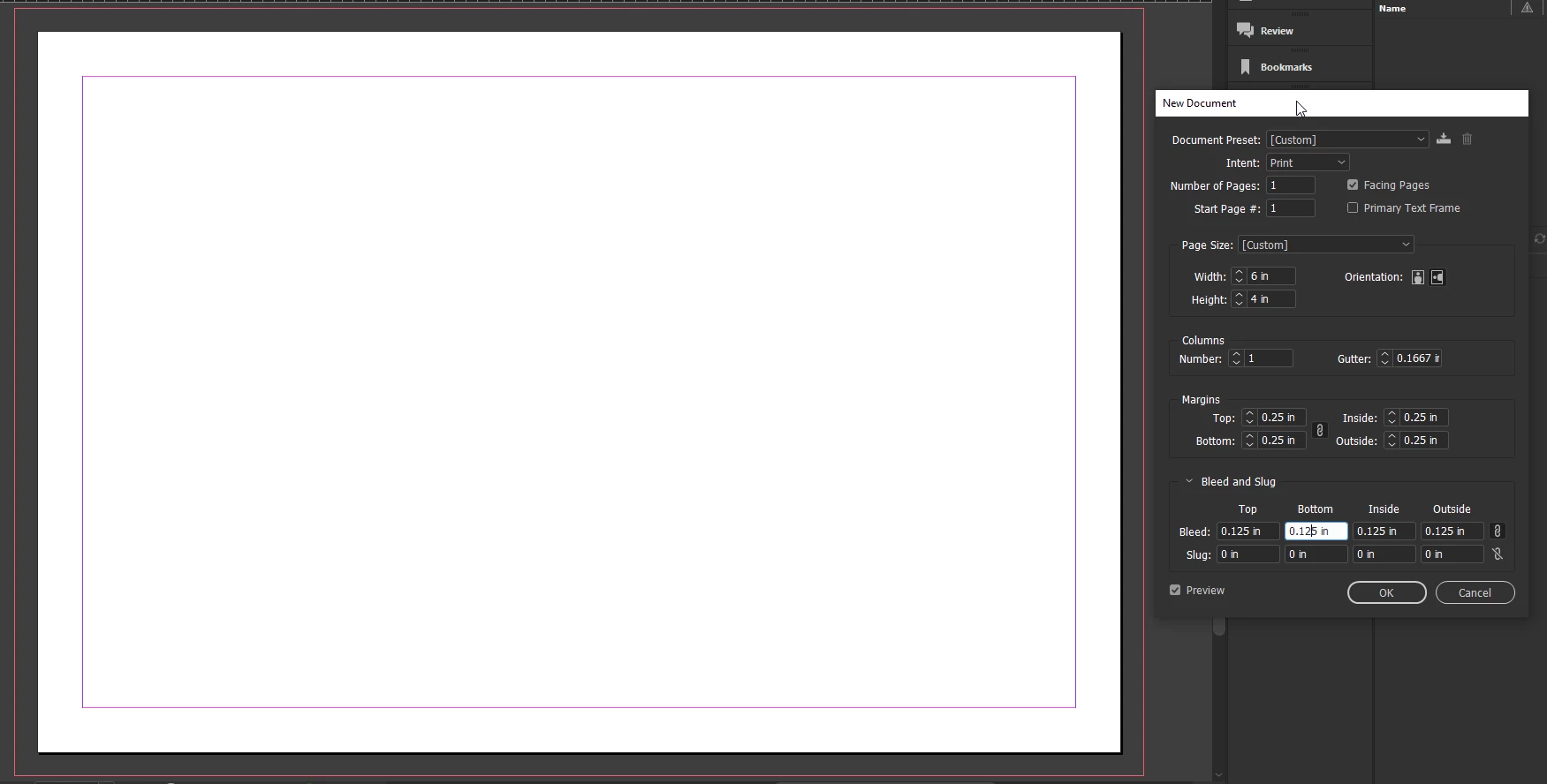

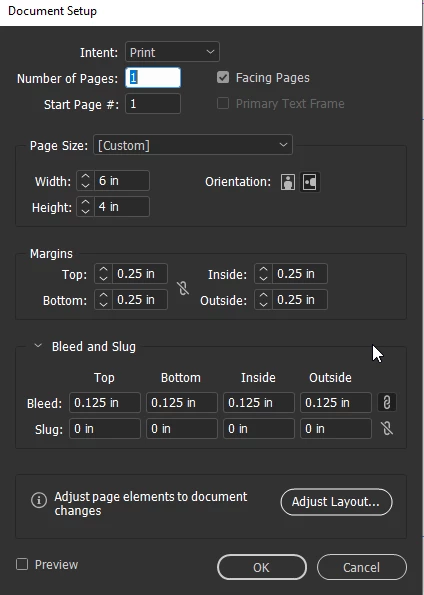

Hi @Tess15A7 Okay. You want 6.25 x 4.25 for full bleed. Check your document set up and your export settings. Margins don't matter as they are your interior settings only, not final overall dimensions.

I made my settings match yours, and the PDF "Actual Size" is 6.2x4.2 (I assume Adobe rounds up).
My new and improved challenge is there is now a TON of space around the outside of the art. Is that just how it is going to be? I want to print a full bleed...did I say that?

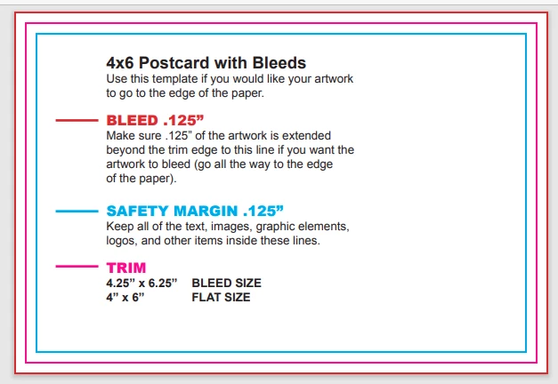

J E L
February 24, 2022
