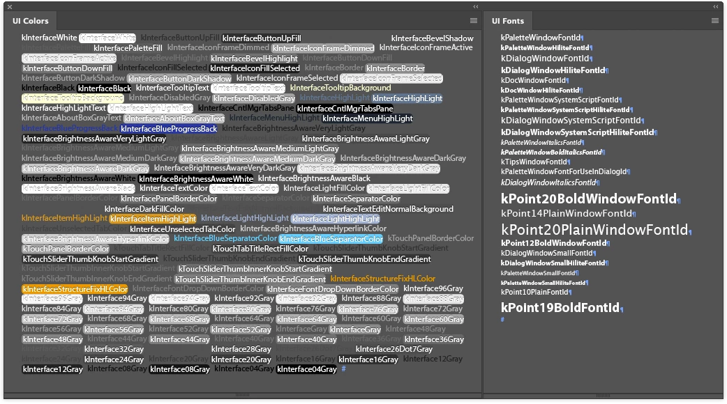

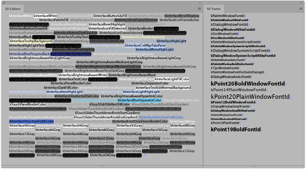

Aug 26, 2024 7:57 AM UTC
Here the UI colors and fonts of 19.4.
One example where the current UI uses different colors would be kInterfaceTooltipBackground.
