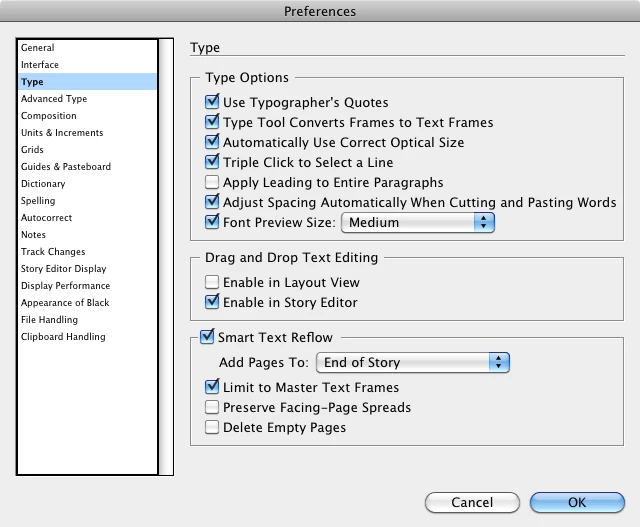

I have the same problem. After reading this thread I actually UNCHECKED the "Triple Click to Select a Line" option in the Type section of my preferences and noticed that it does not make any difference whether it is checked or not! Strange... Really hope they will fix this soon.

And it has nothing to do with the "Triple Click to Select a Line" option.

Jul 18, 2013 8:13 PM UTC
Have you checked the "Triple Click to Select a Line" option in the Type section of your preferences?
You have to click fairly rapidly for this to work, if you wait a second between the clicks it won't work.
Also, 4 rapid clicks will select the whole paragraph. This is good because it also selects the hidden ending paragraph symbol.
(Sometime the ending paragraph symbol has different leading that the rest of the text and it messes up the leading on the final line.
Also check your Mouse preferences in the System Preferences of Mac OSX. There you can adjust the Click Speed. This may have been set to very slow.
Mar 12, 2014 2:35 AM UTC
This setting seemed to be on by default, Unchecking it made the triple click feel more like I expected, although it selected the paragraph instead of the line. Seems like something is buggy with that preference. It screws up double clicking as well, with the triple click preference checked, the text frame (box) has to be active to get multiple clicks to work.
