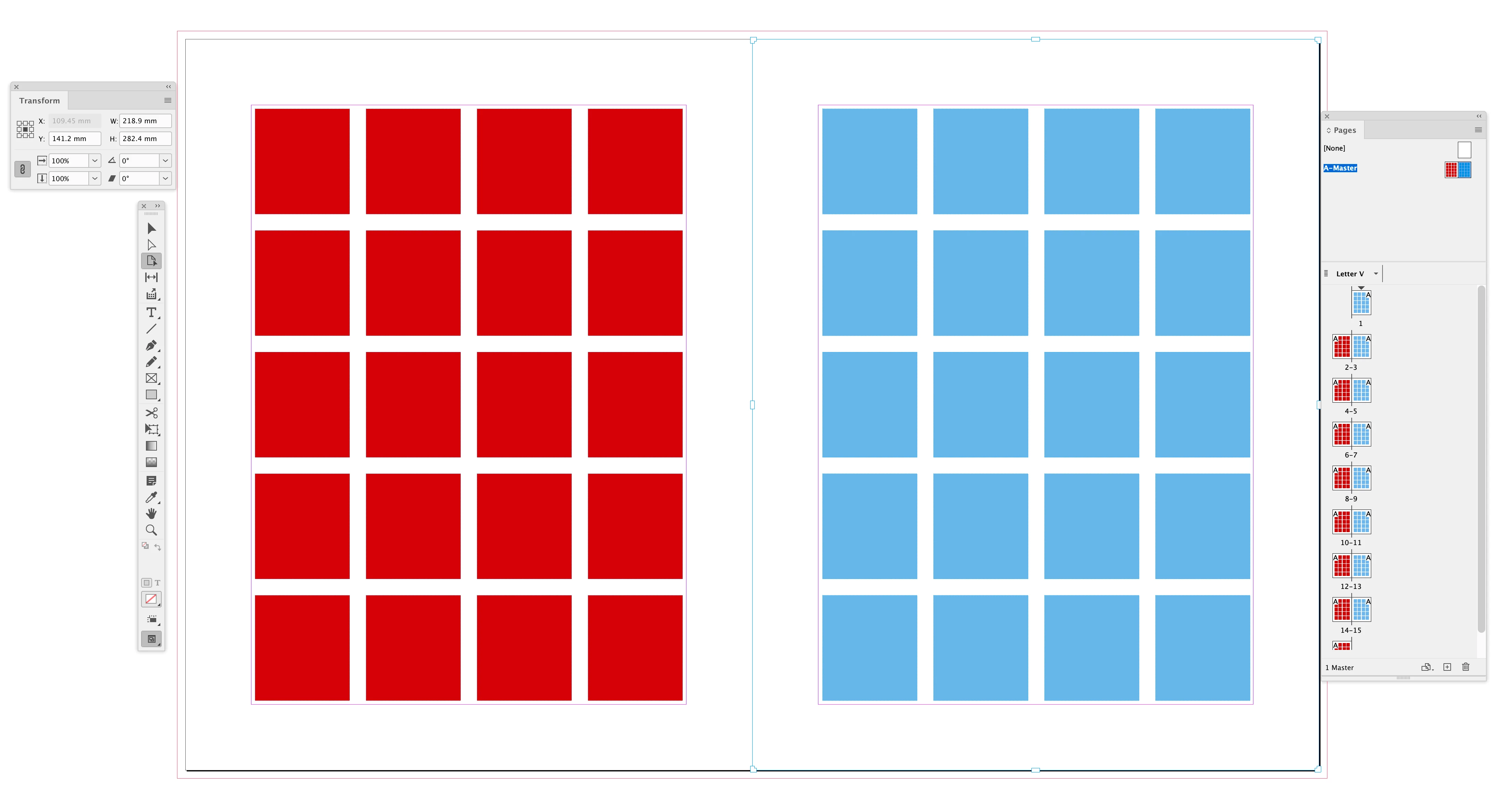

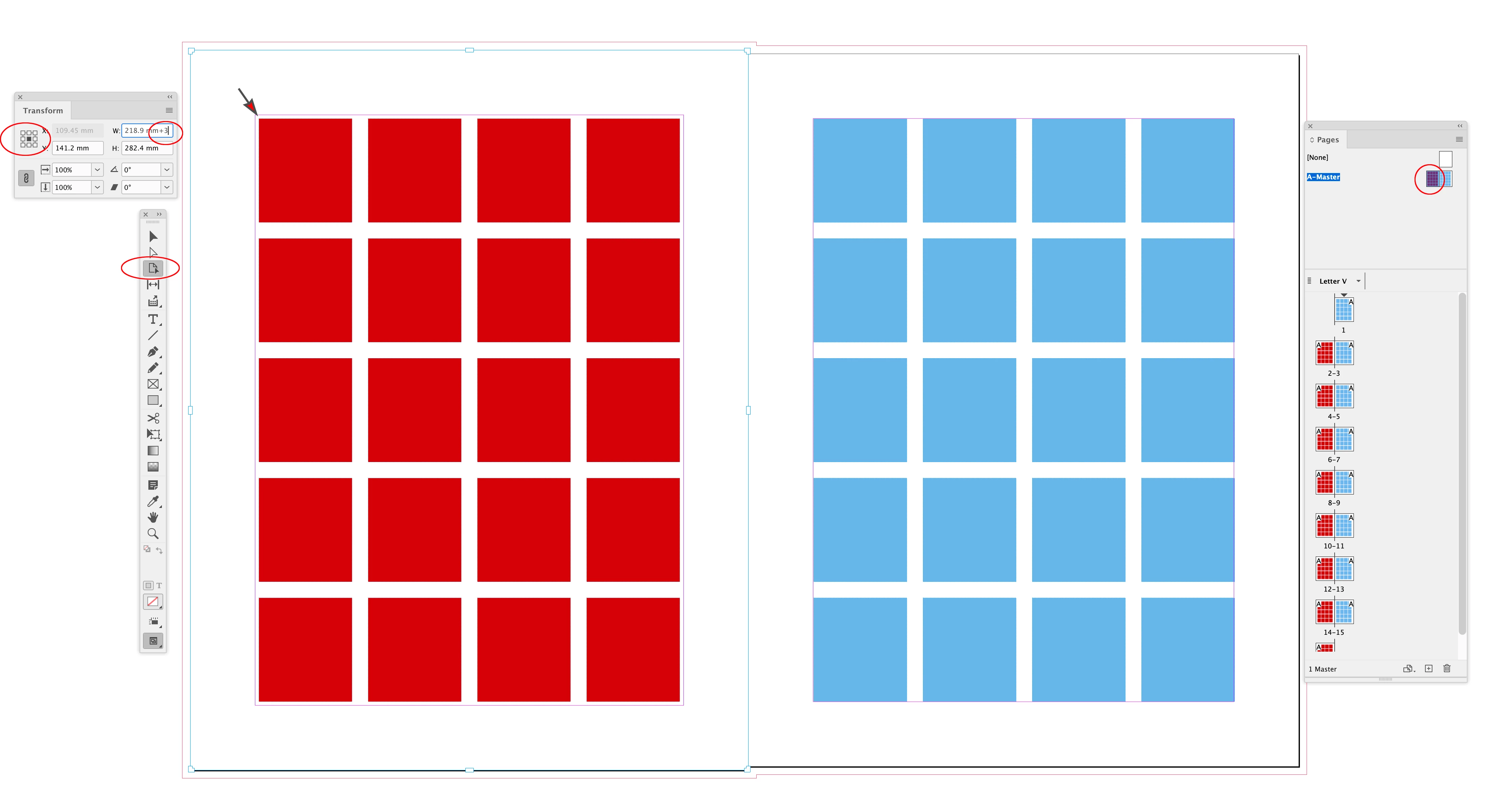

Hi @PlainMartin , have you tried using the page tool with the Transform panel’s Reference Point set to Centered? That should keep all of the page items centered:

Rob, thank you so much! I have admit that in 15 years of working with InDesign, I have never used the page tool, but this is exactly the solution I was looking for. It works perfectly. You have saved me hours of dumb repetitive work. Much appreciated!
