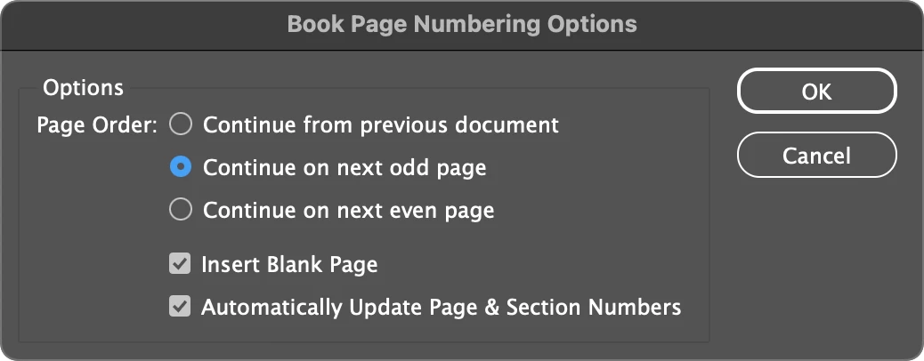

It was defintly a pagination issue on my end. I ended up seeing the INDD's were made in groups of 7's and needing the 8th page added manually. Thus it would literally SHIFT the pagination.

Digging deeper in the meantime. All of this came down to the auto check box being turned on while assembling my book. Since the INDDs are design in 7's and i still needed to add the 8th page follownig each INDD file. I was adding 7-pg documents, then batch loasin 8th-pg document, then reordering. ID was ofcourse doing its jobs in auto rearraging, but since the INDD were set up in a way that the elements on a page were not on masters and just as free floating, ID rearranges and would save the messed up version so I could go back to fix after words.
Once turned off I can arrange book freely without element-shift, then sync, number, preflight/fix, and export.

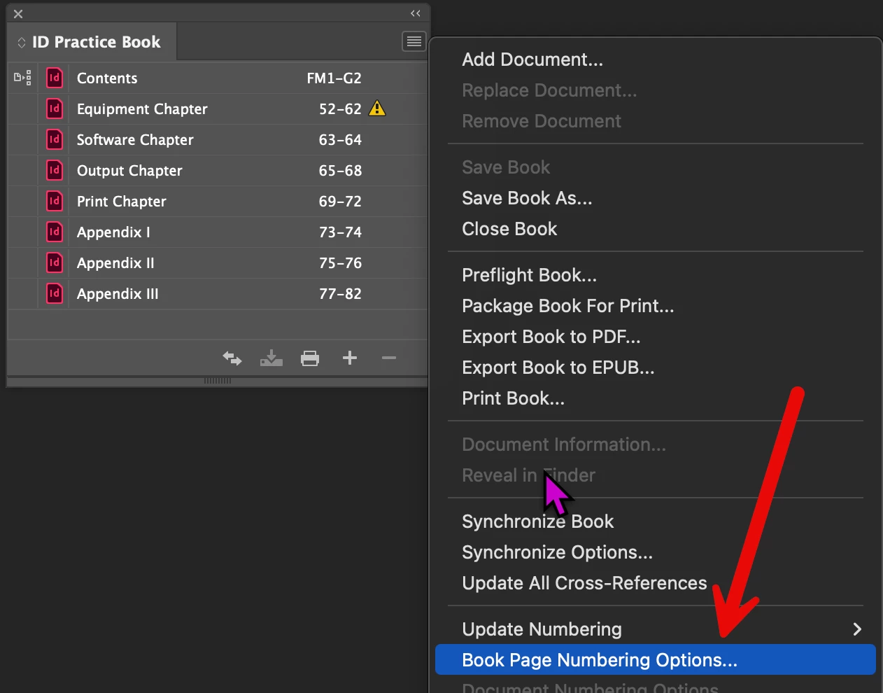

Have you sync'd your book? Depending on your options, that could change documents.
What are your pagination settings in the book? (I don't think you mean "numbering" but pagination (left/right page shifts).
Otherwise, I can't see how a book file would affect a document.

Sorry terminology is a bit rusty. Where can I find pagination settings?

InDesign DOES refer to it as Book Page Numbering Options, so it's understandable one would call it that, but that's a misleading name.
