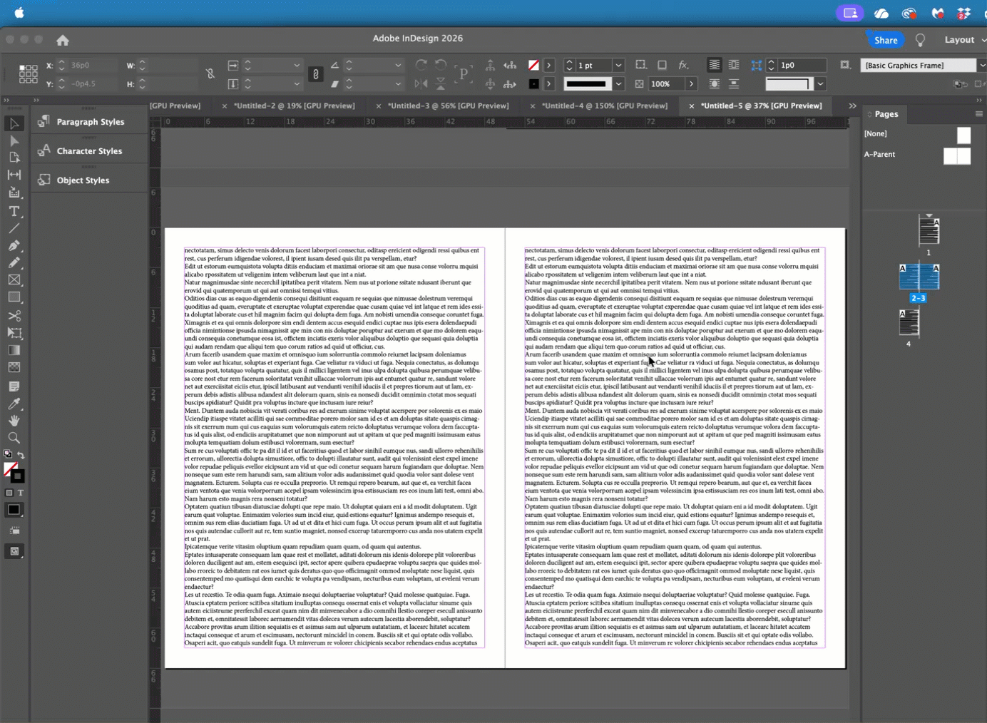

Hi @sidneydavenport:
Auto-adjust Layout should work when the pages:
  1. have frames snapped to the margins and
  2. no page overrides.
Watch page 3 on the right not respond to Auto-Adjust Layout while the other pages did. I'm exaggerating dragging it off of the margins, it doesn't take much.
A better workflow is to use Primary Frames. It's too late for this job unless you want to back up, add them and reflow the text, but next time read up on them before you start.
~Barb
