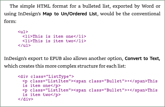

The book noted below is filled with HTML and CSS code... handled exactly as I just described, with ID styles remapped to CSS styles for the Kindle edition. For example...
