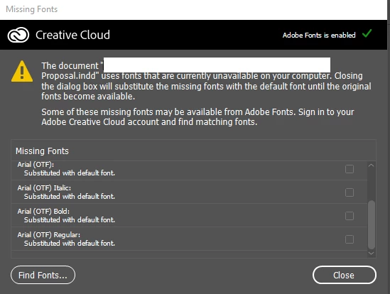

My old template files are now giving me Missing Fonts (Aria (OTF)) when it wasn't before.

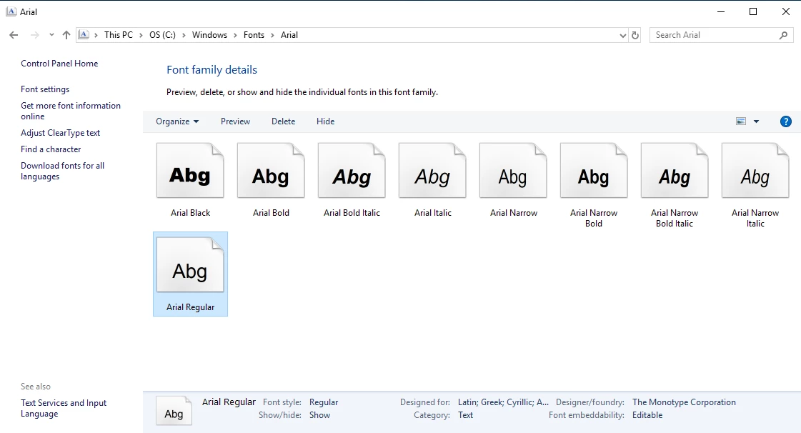

Checking my fonts, it clearly shows that that font is available.

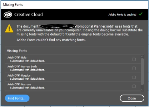

    3 of our Graphic Designers are having this exact issue at my workplace.
    The computers in question were brand new computers almost a year ago and we installed Windows 10 Enterprise 1709 on these computers, at this stage we haven't updated these computers to a later version of Windows so the other forum of Windows 10 not recognising the fonts after updating to a later version of Windows 10 is not relevant here.
    The issue is with the Arial font just as the original poster has raised in this forum.
    I have checked the computer to confirm the fonts exist and the fonts all look to be the same on all our marketing computers and other Windows 10 computers we have in the business. I can see the file name for Arial is called "arial.ttf" in the C:\Windows\Fonts folder.

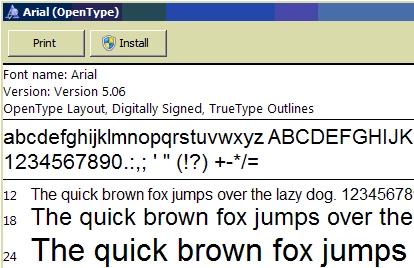

    The name of the font however suggests an OpenType font.

    Not a direct solution (because it should not happen right after an InDesign update), but presumably that Arial is a TTF, not an OpenType OTF. (To confuse things more: either can be the other one as well.)
    Type some text in your "current" Arial and see what path InDesign found it on with Find Font. Is it this one? If you temporarily remove it, can InDesign still find another? Perhaps you have multiple versions installed & active.
