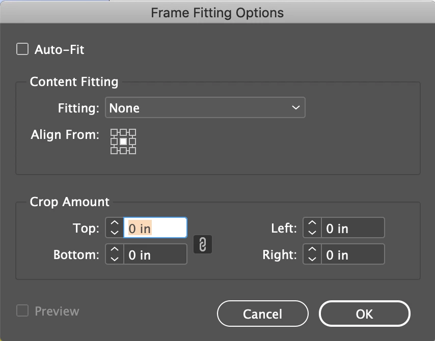

From what I understand about Fitting, if you replace an existing image, InDesign will do the best it can to match the crop amounts of the previous image. So this will have an effect on scale and position of the new image.
If you delete the old image, and right-click on the empty Frame and choose Fitting > Clear Frame Fitting Options, the crop amounts from the old image will be reset to 0 on all sides. This should solve the problem.

Select a frame and check out the settings in Object > Frame Fitting > Frame Fitting Options. Are there settings on the frame that are forcing the new image to adapt?

see attached, my fitting settings are set to none. There is a certain amount of crop, but thats because the pdf is bigger than the box its placed in, but then so is the link im replacing it with. Im wondering its because the current placed pdf is placed by its media box and the pdf im relinking it with has a different sized media box.... thus indesign is scaling the new link to fit? this is strange as i have previously said I have content aware fit turned off.
