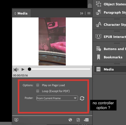

Hi everyone!
I hope you are all safe and well 🙂
Really hoping someone can help me with this one as I'm submitting my final university project in a few days and I can't seem to fix this issue!
I want to be able to modify/add a stop - play - pause bar on videos that I have added to my doc, but when I insert the vid and click on media pannel there are no options for this? I'm sure it used to be called controller?
Is there something really simple I'm missing here? Getting really stressed out lol x
Correct answer JonathanArias
correct. indesign 2020 did away with all options in your indesign panels which used flash technology. thats one of them in that panel.
If you absolutely need to have those controls, install indesign 2019 or older to open that file ( make a .idml).

I had the same issue, no controllers after exporting 'interactive PDF'. Troubleshooting:
  • open the PDF with Acrobat
  • right-click the video and make sure it's de-activated
  • that's how you could reach the 'properties' panel.
There you change everything you want, even placeholder image, controls, fullscreen, autoplay, ...
