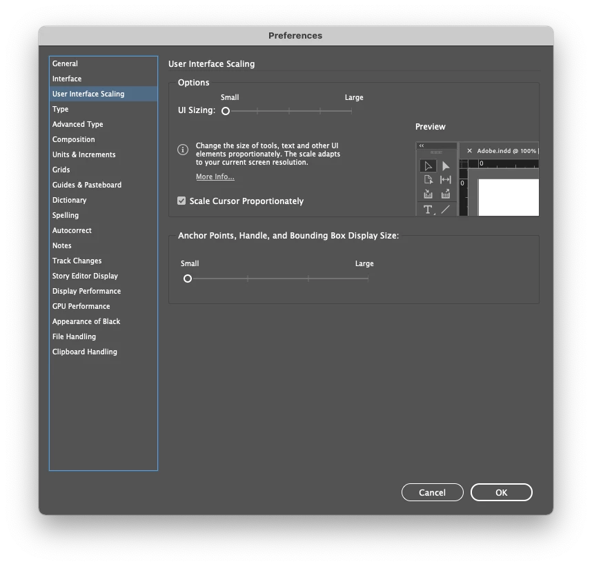

I'm also experiencing this problem on my Mac Studio and iMac both with second Apple displays. My UI setting is already at the minimum (Small) so I can't scale it down any more. I've also reset my cache and that hasn't helped either so I'm not sure what else I can try?

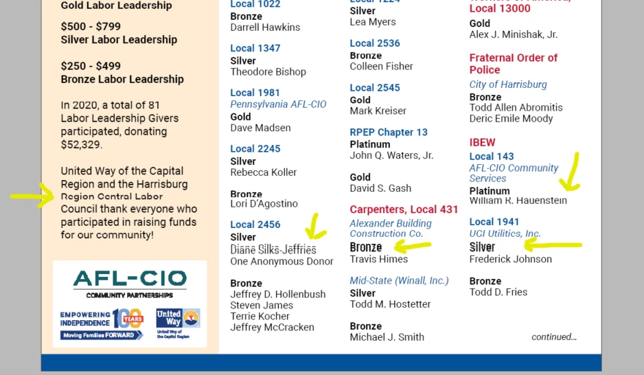

I'm having issues (using on a Dell, not MAC) but a slightly different glitch. My problem is within the various boxes (text or object). Sometimes text gets cut off. Sometimes an object box's frame shape is off. It's bizarre and totally random. I'm attaching a sample of a text issue. I drew yellow arrows to point out the issues. The text in the white area is all in the same text box with columns. The issue in the yellow box is a completely seperate text box but still glitchy. If I scroll down to the next page and come back up, it sometimes fixes it but not always. Or it'll fix the original problem but there will be a new glitch in a new area. It's driving me nuts and I'm thinking about just going back to InDesign 2021 until this is fixed. I need to know that what I'm looking at is in the right place and looks correct. Sigh.
December 9, 2021
That definitely looks like a similar display glitch we have been encountering. It may be a specific issue with Dell displays or Dell display manger as others have mentioned these monitors, and my issue was with a Dell U4021 on a Mac mini. If I didn't find this thread that solved the issue for me, I would have reverted back to an earlier version of InDesign, as the issue is maddening. Waiting for an InDesign update might be the easiest solution that doesn't waste any more time hunting for a fix.

Hey, everyone. Check the User Interface Scaling under Preferenes. I just notice when viewing actual size (100%) my project was not represensted at the correct size - it was too large. I turned on the ruler and noticed, yup, things are scaled here; the inches are very large inches.
I moved the UI scale to the smallest setting (probably meaning no scaling) and the project now displays 1:1 on my screen (as measured by my handy ruler), and the glitchyness seems to be gone. In fact, everything looks as it should now.
