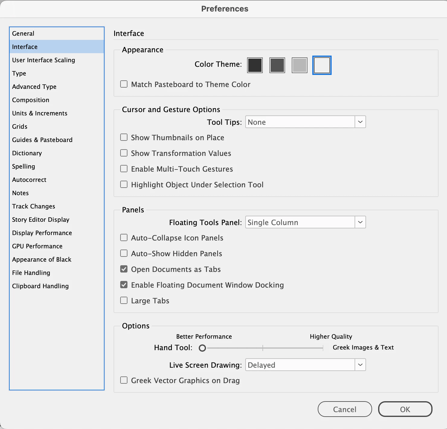

What I did earlier today was go into my InDesign preferences > Interface and start to uncheck alot of the boxes that were checked. Then I restarted the program. With this, it seems to have stopped that lagging issue O(0_0)o !! I hope this stays like this. I don't want to jinx it, but for now, this seems to have solved it! I appreciate your thorough response!
