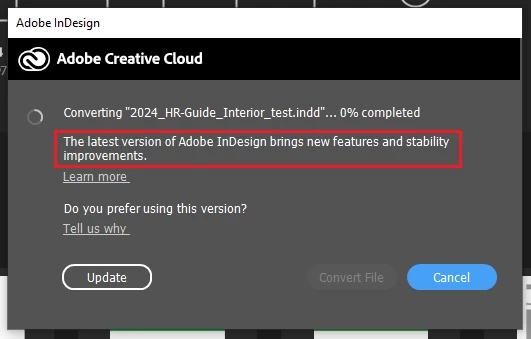

I had to open some file today - created in the latest version - and got this:
Looking at the number of posts with complains...

@Robert at ID-Tasker said: "… I had to open some file today - created in the latest version - and got this: "
Hi Robert,
do you see this message "Converting …" with the release version of InDesign 2025 version 20.0.0.95 ?
If yes, maybe the file was created in a previous Prerelease or Beta version of InDesign with a feature set that does not match the actual release version?

That's not the point of the screenshot 😉
