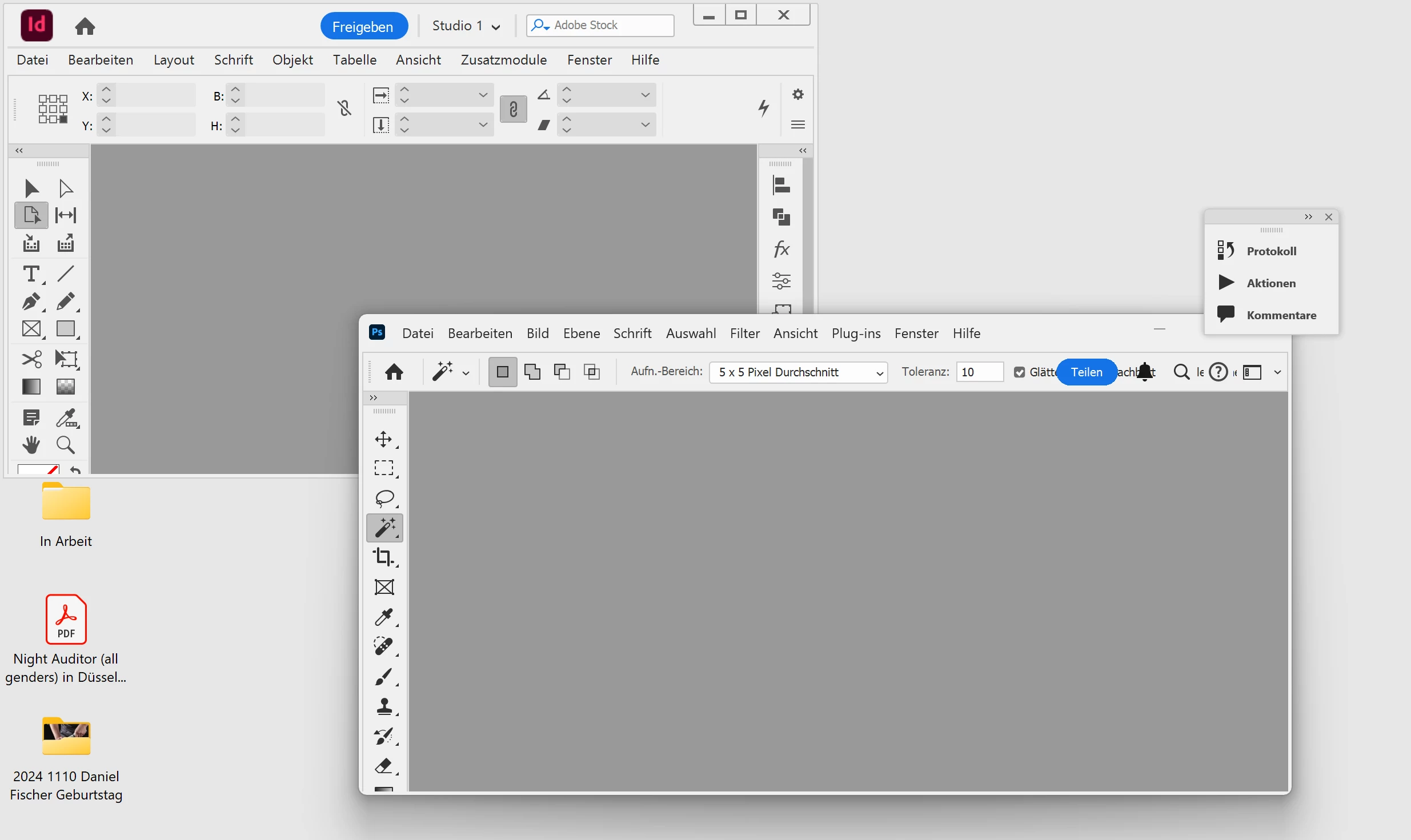

Nov 8, 2024 3:04 AM UTC
Attached is a screen shot of the display. Even with just one monitor/laptop display, I have the problem that I can't position the InDesign window anywhere on the display. It gets stuck in the top left corner. As you can see, it's not a problem with the Photoshop window.
Photoshop also works with a second monitor. Even with a stretched desktop.

Hi @Robert36875432qgwn,
Thanks for the screenshot! Based on the issue you're describing, it seems like the InDesign window is not behaving as expected, even on a single monitor setup.
To help us narrow down the cause, could you try the following steps?
1. Hold down **Ctrl + Alt + Shift** (Windows) or **Cmd + Option + Shift** (Mac) while launching InDesign. This will reset preferences and might help resolve any window behavior issues. Reference: https://adobe.ly/4hEWpmT
2. Ensure that the display scaling settings in your OS are set to 100%. Sometimes, higher scaling can cause window positioning issues.
3. Make sure your graphics drivers are up to date, as outdated drivers can sometimes cause display issues in Adobe apps.
Let me know how it goes after trying these steps, and feel free to share any other details that might help.
