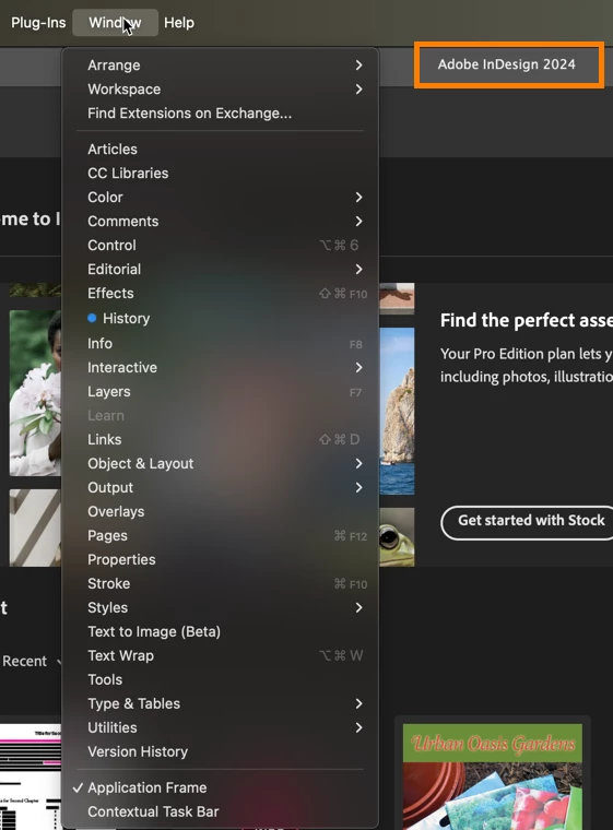

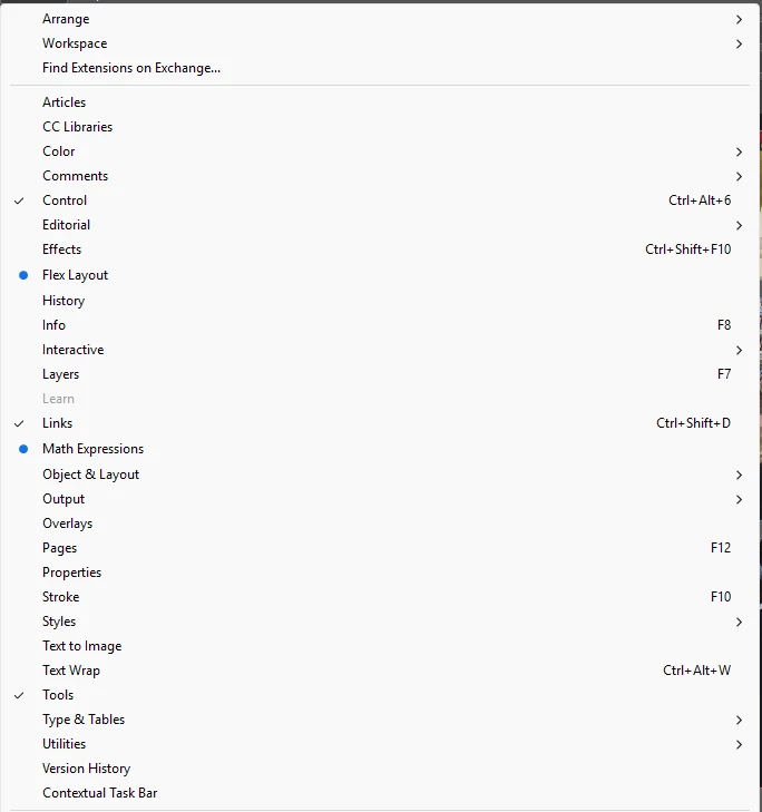

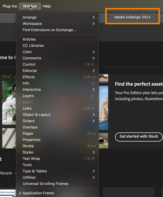

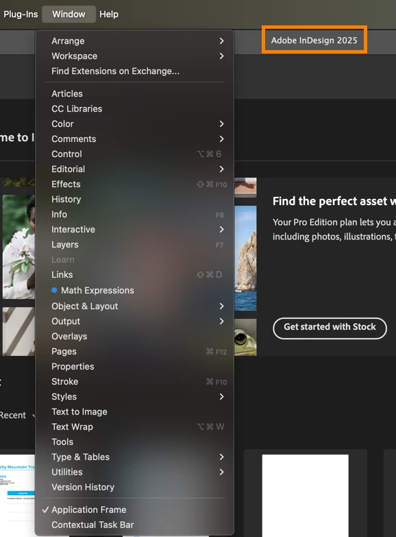

Oct 29, 2025 2:08 AM UTC
I noticed that after downloading the InDesign 2026 app, it removed the extensions section out of the Window panel. Has this been moved?
There's no Window panel so you must mean the Window menu?
Here are screenshots of the Window menu in InDesign 2025, InDesign 2024, InDesign 2023 and InDesign 2022:

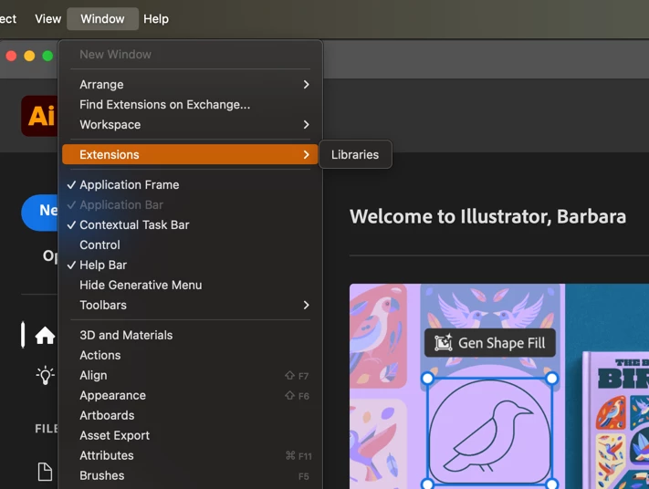

Following up with @Abhishek Rao logic, here is Illustrator's Window menu in 2026.
~Barb

Oct 28, 2025 9:14 PM UTC
On the 2025 app, the version is 20.5. 
leo.r
Oct 29, 2025 1:47 AM UTC
quote
By @Chase33635940qwag
Interesting. All I know is that I don't have the Extensions menu in InDesign 2025 either.
And what are the submenus in your version?
