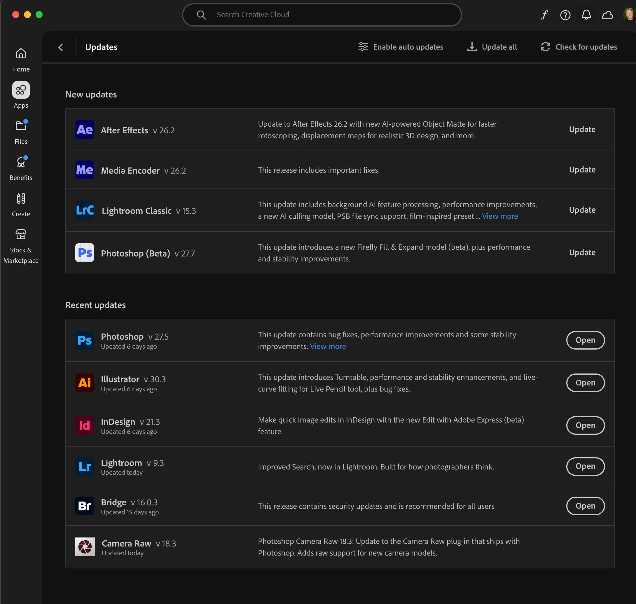

    Ziggy_Gsy
    Ziggy_GsyAuthor
    Apr 16, 2026 9:10 PM UTC
    Hi Bob,
    Here is a screenshot from ‘Creative Cloud’ ot which version of Adobe InDesign I’m running on my Mac OS.
    Yes, you’re right. I did say 21.0, but it is, in actual fact, 21.3 that is giving me all this ‘linking’ love and joy to my life. Seriously, though, after the Mac reboot and the subsequent link fail, I now have 130+ links to reconnect, again. And this happens after every reboot, every day, with every InDesign file. I love InDesign, but I have to say this is getting me down.
    Many thanks,
    Ziggy

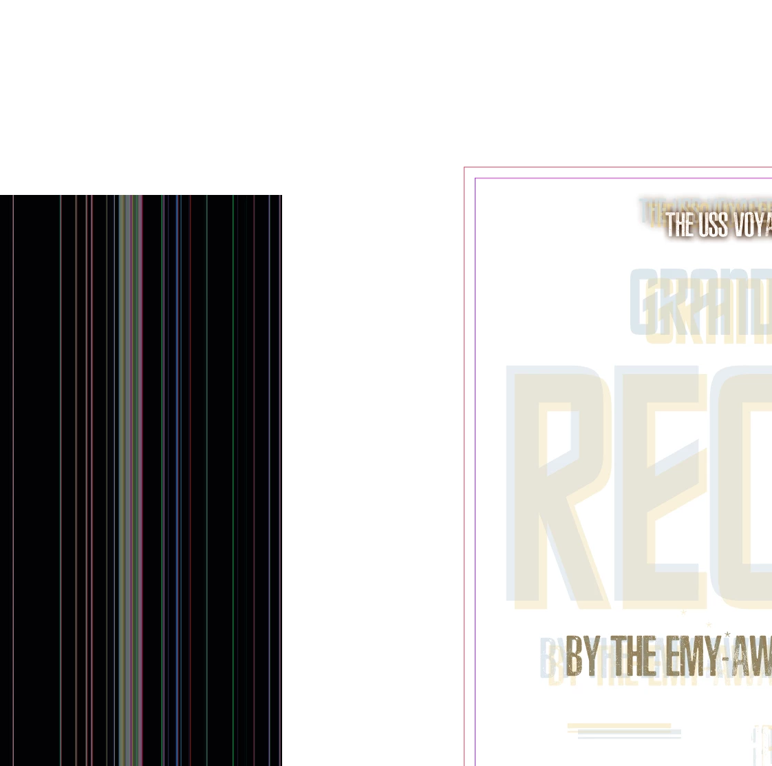

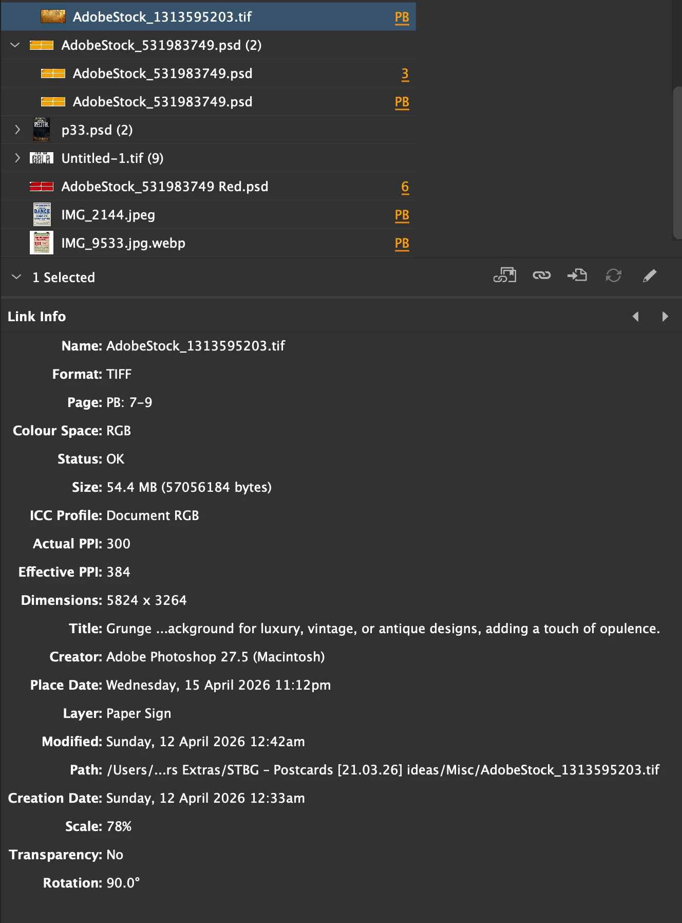

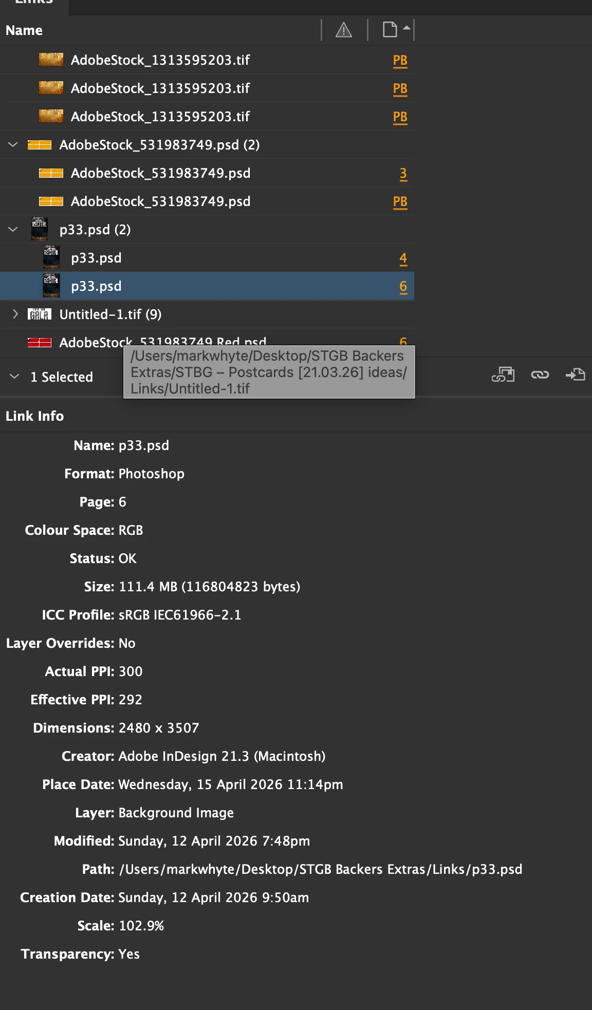

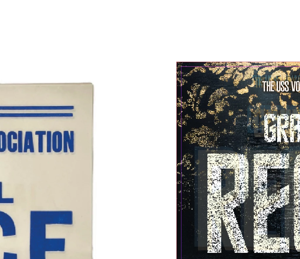

    Ziggy_Gsy
    Ziggy_GsyAuthor
    Apr 16, 2026 8:50 PM UTC
    Hi Leo,
    Thank you for your response. Please find the requested screenshots attached.
    To answer your question about InDesign 2025 — I no longer have it installed on my Mac, so unfortunately, I'm unable to test the same documents in that version. However, I can confirm with certainty that this behaviour did not occur before the 2026 update.
    The screenshots tell an interesting story:
    1. The Links panel reports Status: OK on all affected links (see screenshots 3 and 4), yet the files are clearly not rendering correctly.
    2. The difference between Typical Display and High Quality Display (screenshots 1 and 2) is dramatic — in High Quality Display, one linked image renders as a completely black screen with coloured scan lines, and another as a heavily pixelated mess. This strongly suggests InDesign cannot actually access the linked files despite reporting them as healthy.
    3. Both affected links are stored locally on the Mac at consistent paths — there is no network storage, external drives, or cloud sync involved, and the file names and paths never change between sessions.
    4. I also noticed a tooltip in the Links panel briefly showing a different path to the one stored in Link Info for the same file, which may be relevant.
    As a workaround, I have tried exporting the document as IDML and reopening it as a fresh .indd file. So far this appears to be working, but I have not yet rebooted the Mac to confirm whether the problem returns after a restart — which is typically when the issue reoccurs.
    The file types affected are PSD and TIFF, both created in Adobe Photoshop 27.5 on the same Mac.
    I hope this additional information helps to isolate the issue. I'm happy to provide further details if needed.

    I wonder if, by any chance, the problem is only affecting links whose path has a folder whose name contains square brackets and/or periods?
