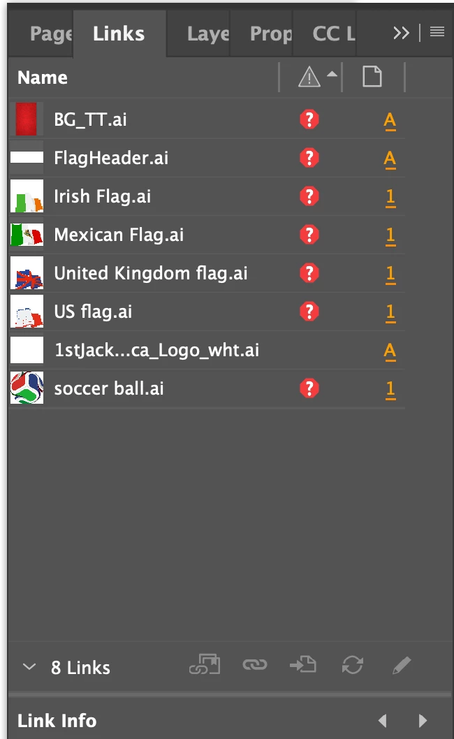

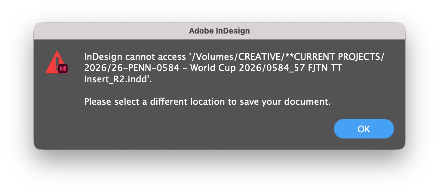

    The Synology drive is partitioned into 4 different Volumes. I opened 10 files to edit. 4 edited & saved fine, then working on the fifth, it dropped the “Creative” volume. Finder window blank for that volume on my desktop. 3 other volumes still mounted & navigable. 1 link in file (to Client & Supplier Assets) still connected. All links to Creative dropped. And can’t save file to Creative volume.
    links panel
    save diaglogue

    We look forward to the additional details, especially a screenshot of the exact error you see while saving, as that will help narrow this down further. Could you also confirm if you are currently using SMB as the protocol and ensure it is on the latest supported version on your setup.
