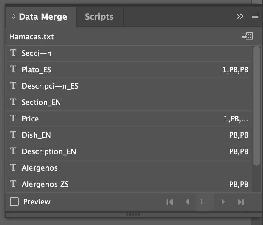

After updating to InDesign 21.5, Data Merge no longer handles accented characters correctly when I run my InlineMerge JSXBIN script.
For example:
Sección becomes Secci—n
Descripción_ES becomes Descripci—n_ES
The problem affects both the Data Merge field names and the merged text.

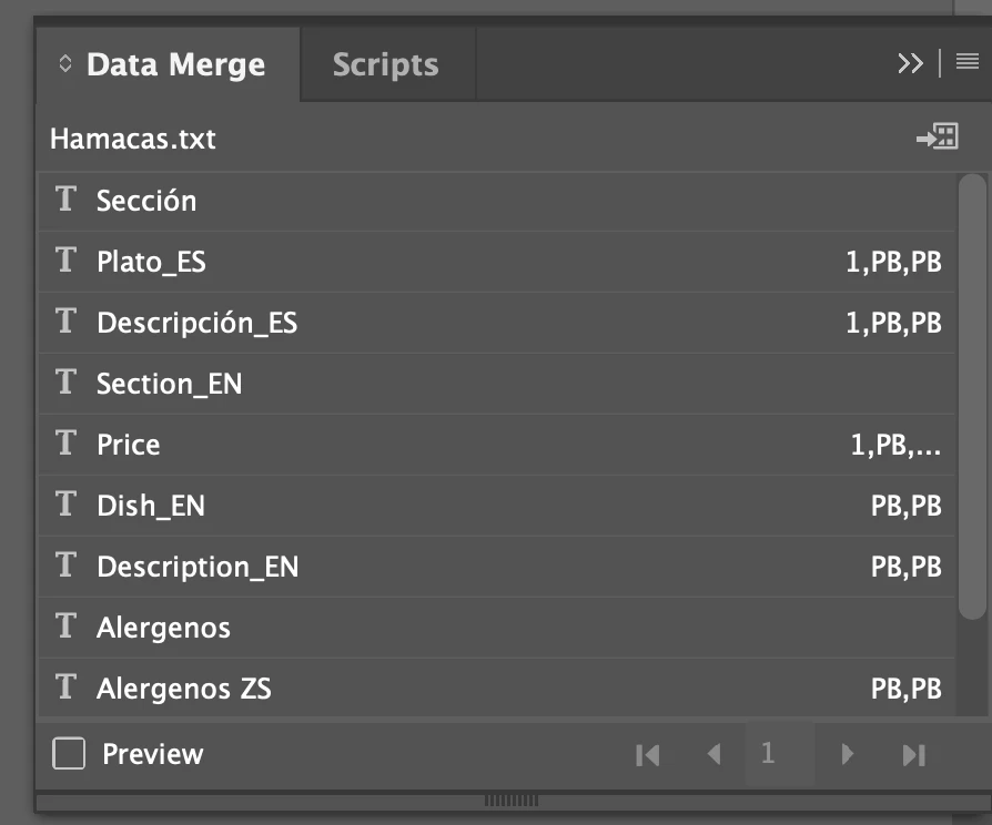

Steps to reproduce:
  1. Create a new InDesign document.
  2. Load a tab-delimited TXT file as a Data Merge source.
  3. The field names containing accented characters display correctly.
  4. Run the attached/linked inlineMerge.jsxbin script.
  5. Accented characters are replaced by incorrect characters, e.g. ó becomes —.
Important: The exact same TXT file and the exact same script work correctly in the previous version of InDesign.
I rolled back to the previous version and the problem immediately disappeared.
This appears to be a regression in InDesign 21.5 affecting Data Merge and/or the scripting API used by the script.

    Update: I think I’ve found the cause and a workaround
    After the latest InDesign updates, InlineMerge stopped working correctly with some special characters, particularly ñ and accented vowels. This was not happening with previous versions of InDesign.
    After quite a bit of testing, I found that the issue seems to be related to the encoding of the TXT file used for Data Merge.
    Saving/exporting the TXT file as UTF-16 fixes the problem. The special characters are preserved correctly, and the text remains unchanged after running InlineMerge.
    It’s also worth mentioning that InlineMerge hasn’t been updated for many years, so it’s actually quite amazing that it continues to work with current versions of InDesign!
    For anyone experiencing the same issue after updating InDesign, I would recommend checking the TXT file encoding and trying UTF-16 before assuming that InlineMerge itself is broken.
    Hopefully this helps others who may run into the same problem. And thanks to everyone who helped investigate this!

    To reproduce the issue:
    1. Open a new InDesign document.
    3. The accented characters display correctly at this point.
    4. Run InlineMerge.jsxbin.
    5. Characters such as ó are replaced by —. For example, Descripción_ES becomes Descripci—n_ES.
    I tested the exact same TXT file and the exact same script in the previous version of InDesign, and everything works correctly.
    I have currently reverted to the previous version because I use this workflow daily and need the Data Merge to work reliably.
    I hope this helps you identify whether this is a regression in InDesign 21.5.
    Best regards
