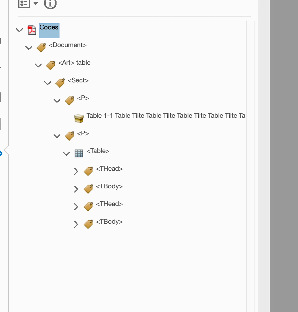

    I’ve download your example and exported it as a tagged pdf 1.7, using your Articles.
    It exports as expected, the complete table tagged including the stupid multiple THeads and TBodies (which is wrong and a InDesign fault, there should be only one THead and one TBody)
    So I see nothing strange about this.
    I do see in your screenshot that you use PDFix, maybe you leveled it up (using the fixes in PDFix)?
    Anyway, it is not InDesign here doing this as I could test you document (see screenshot)
    ​@Abhishek Rao Your screenshot makes no sense, this is not standard InDesign export behaviour…
