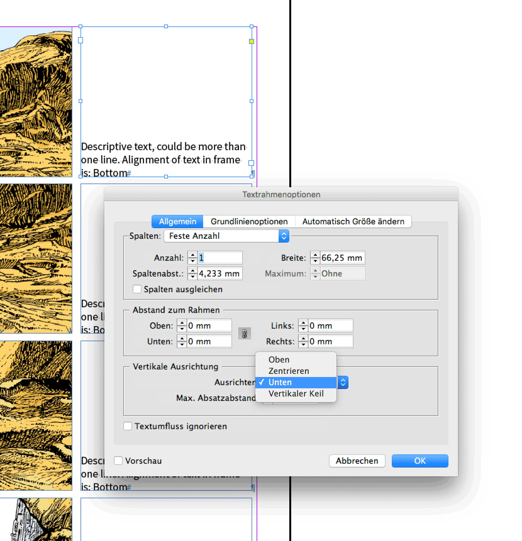

    Text frame options for alignment of text inside the frame is set to Bottom alignment:

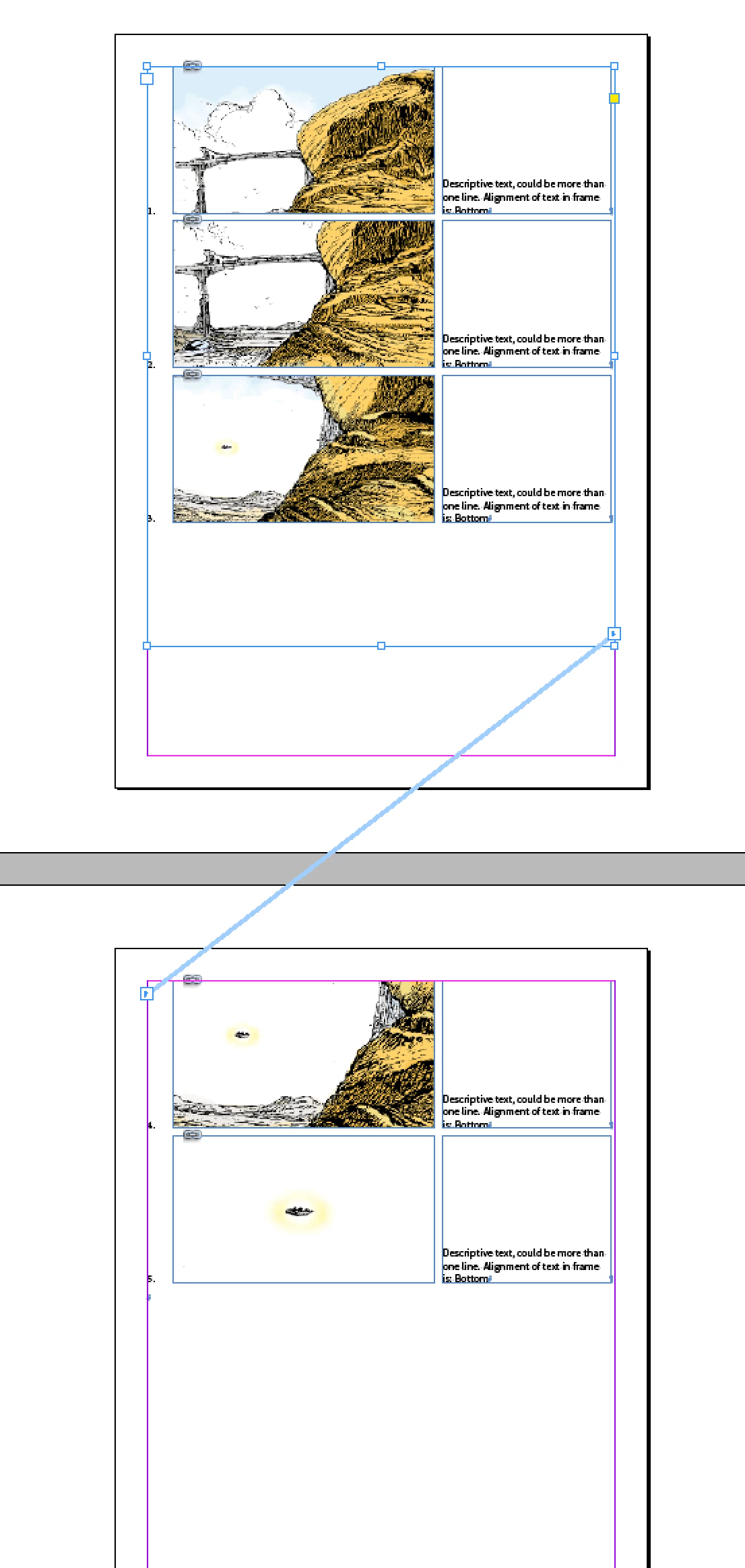

    Forgot the view on two text frames threaded over different spreads:
    You could always add paragraphs or remove whole paragraphs:
    The numbering will change accordingly.

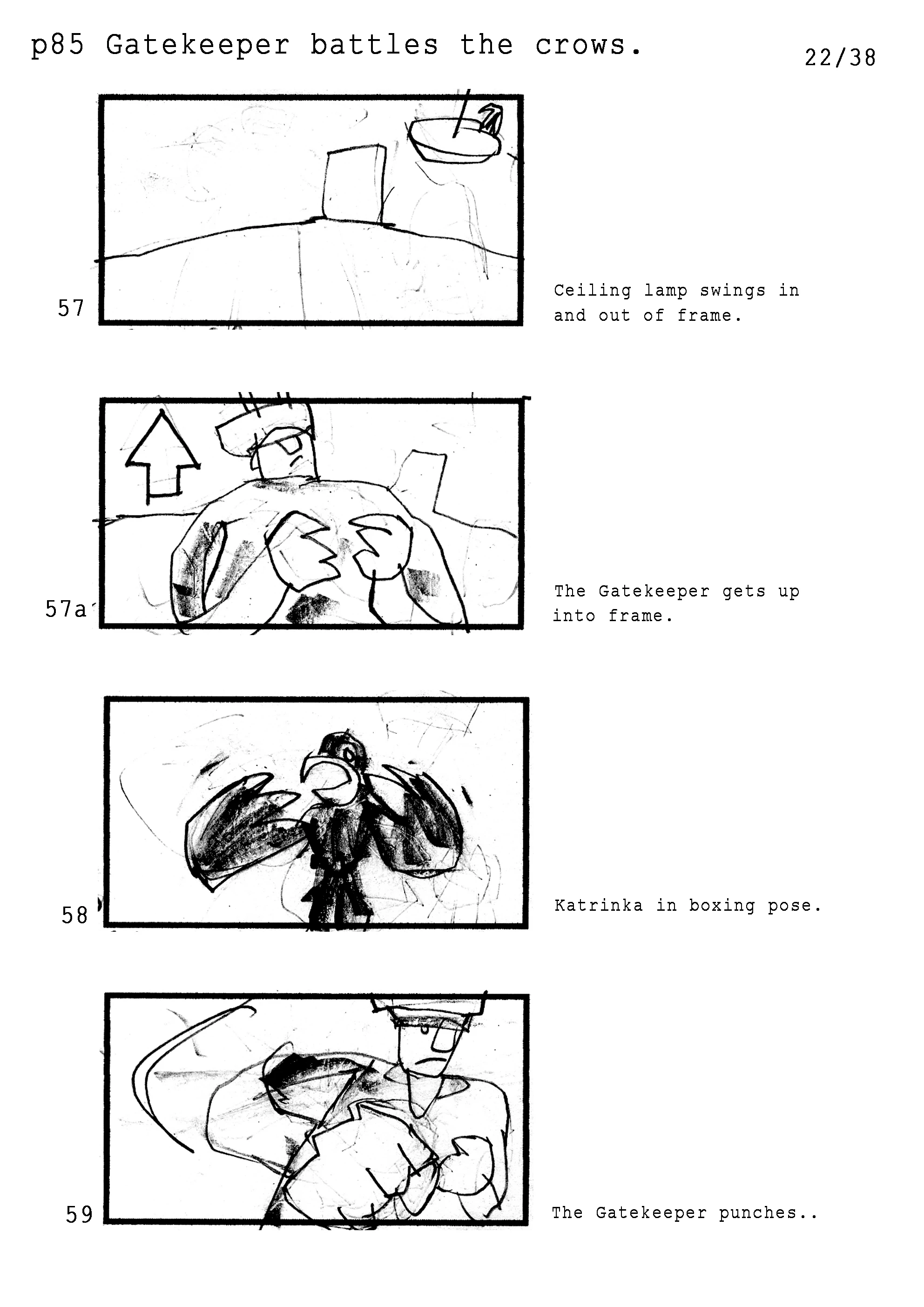

    Hi Uwe
    Thanks for the response.
    Here is a sample sheet. It would also have scene numbers alongside each panel - information that would not move with the panel image.
    All the best.
    Jake
