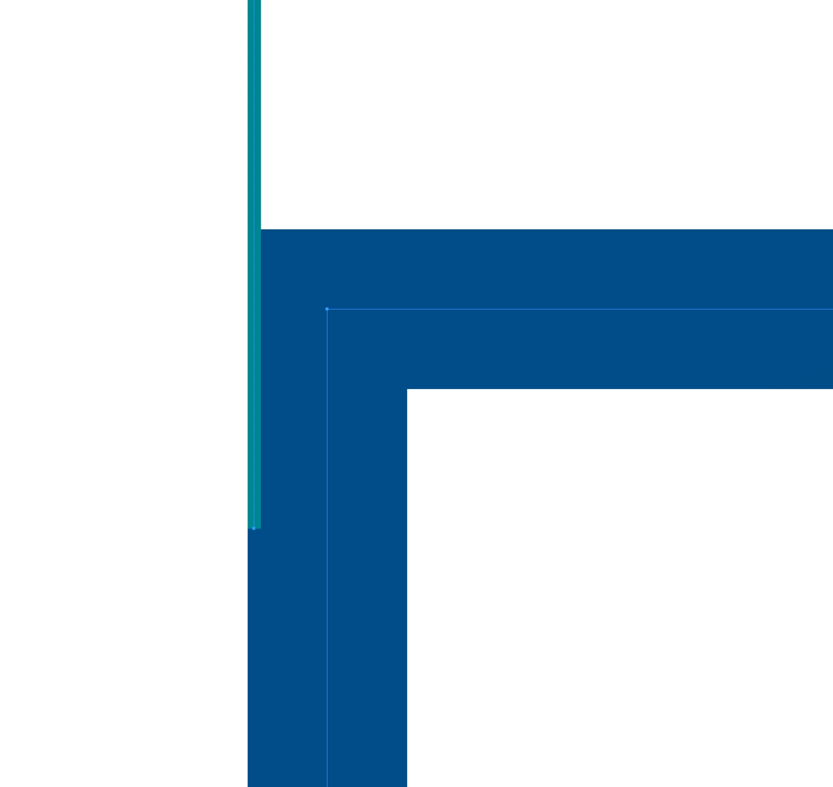

When I draw a rectangle with a thick stroke and try to align it to a guide or the page center, InDesign aligns it based on the outer edge of the stroke, not the object’s true center.
In Illustrator, alignment ignores stroke thickness (which is what I want). But in InDesign, it always includes the stroke, which shifts the object slightly.

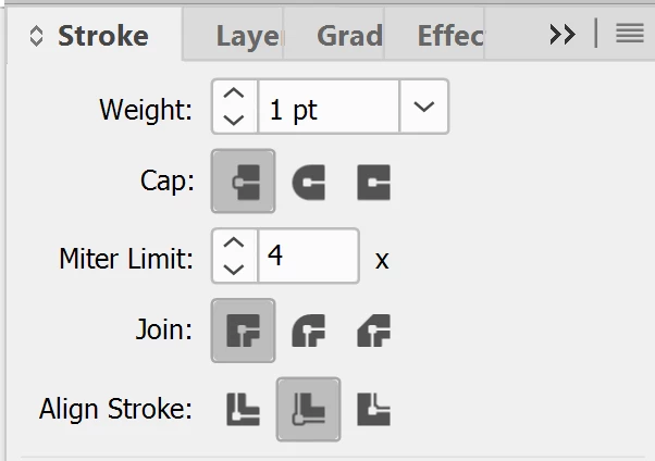

I often set the Stroke alignment to Inside. See this screenshot of the Stroke panel.
This way, your bounding box and overall size are going to agree.
