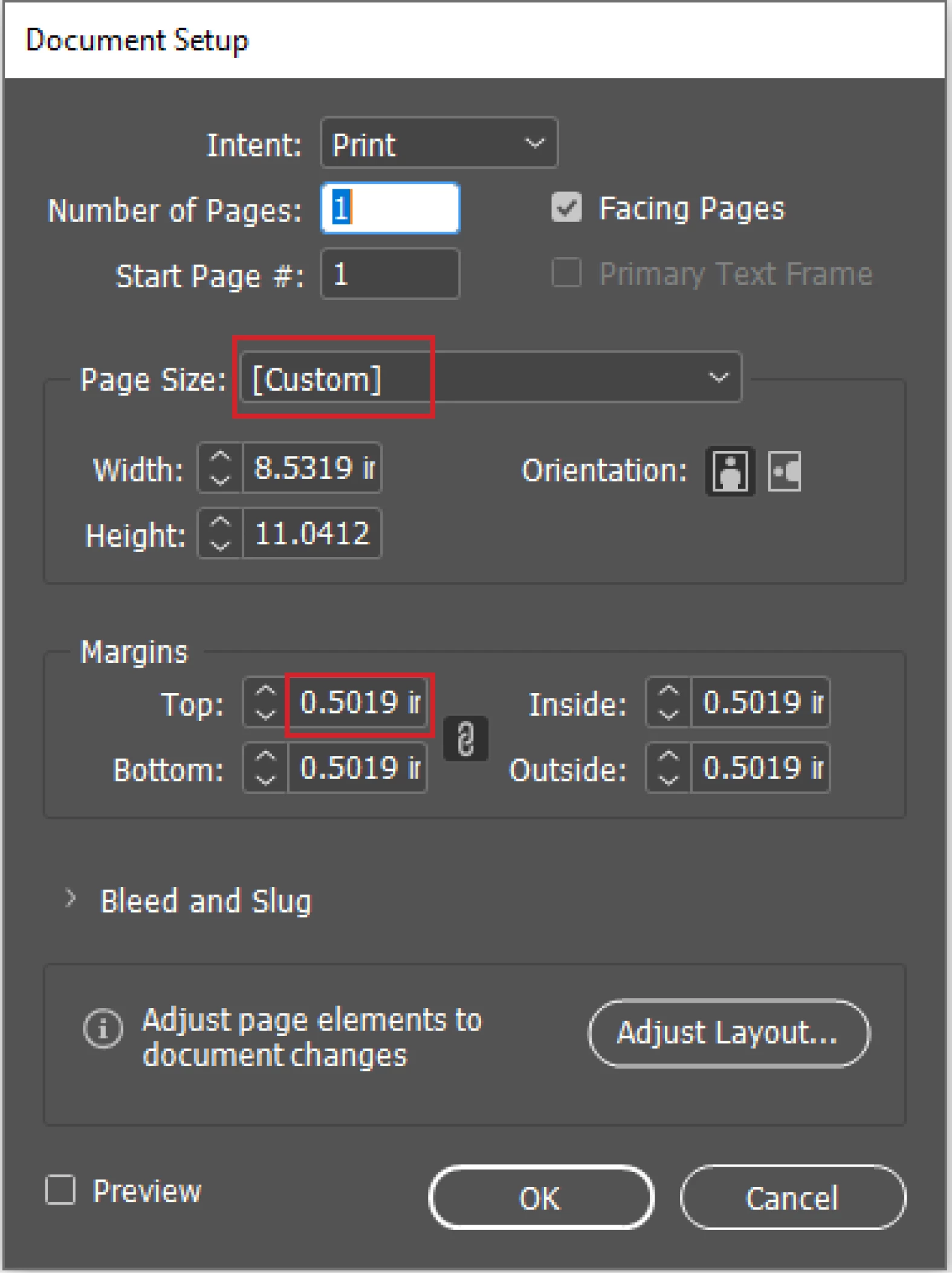

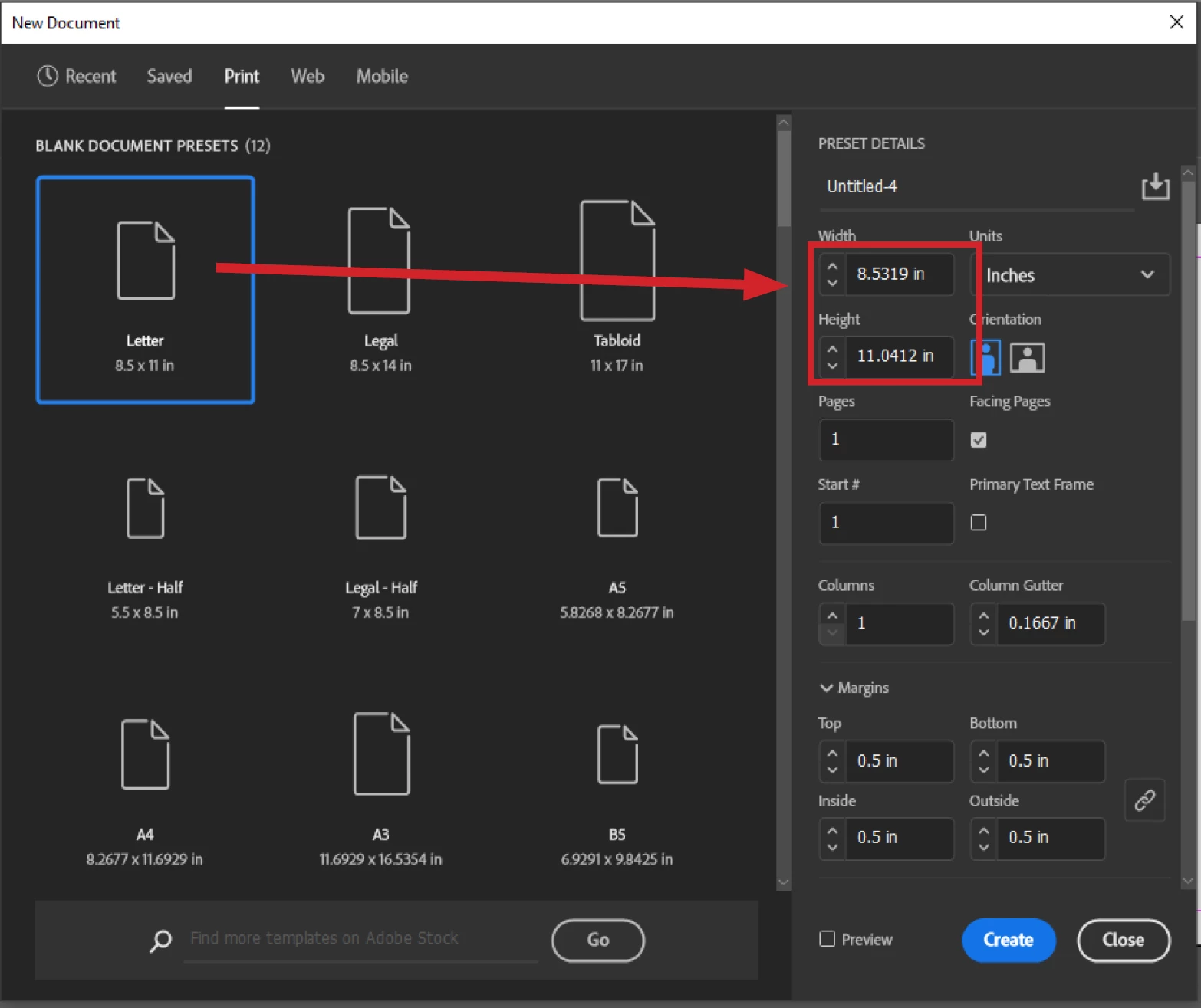

Hoping someone know how to fix this! Something is wonky with my blank document presets in InDesign. Nothing custom, just the normal standard pages (letter, legal, tabloid, etc.) are all slightly larger. For example the preset for a new "print" 8.5 x 11 letter size document looks like this:
If I create this file, the document setup shows the page size as "custom" and also increases the margins from 0.5 to 0.5019 like this:
Any idea how I set these back to normal?
Correct answer Barb Binder
Hi @stylish_maker6609 :
Change your Preferences > Units and Increments back to Points/Inch: PostScript 72 pts/in.
~Barb

Barb BinderCommunity ExpertCorrect answer
May 20, 2022
~Barb
