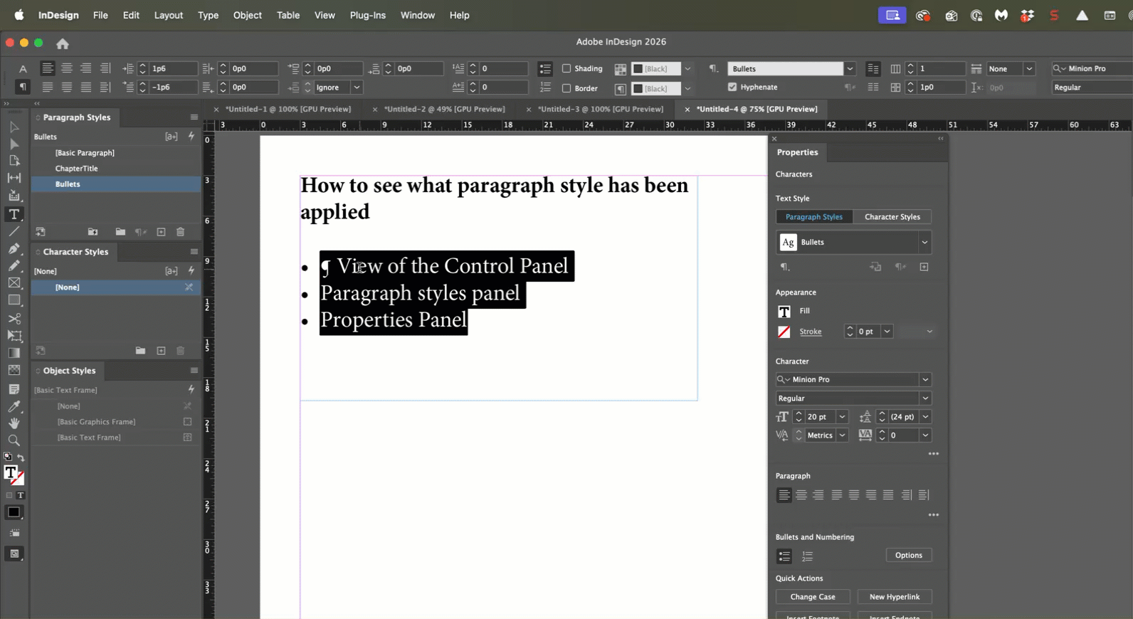

You can see the applied style on the body pages: either in the ¶ view of Window > Control panel, or Window > Styles > Paragraph styles panel or in the Window > Properties panel.

So it sounds like you set up the running header variable to collect the Chapter Titles. Is the chapter number—which us now showing up in the running head—assigned the paragraph style Chapter Title?

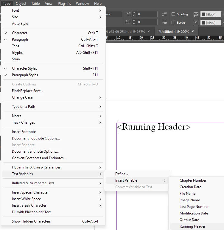

The Running Header variable collects the first occurrence of the referenced paragraph style. If you clicked at the beginning of the Chapter Title, pressed Enter, arrowed up and added the chapter number then it is using the same style as Chapter Title. Change the style name to something different, like Chapter Number.
As for the case, we can format text to appear in all caps but when you collect the text from the source files, it pulls it in as it was originally typed. Select the words chapter 22 in chapter 22 and choose Type > Change Case > Upper Case. Page down to see if that corrects it.

Check what variables are being used.
Running Header or Chapter Number
