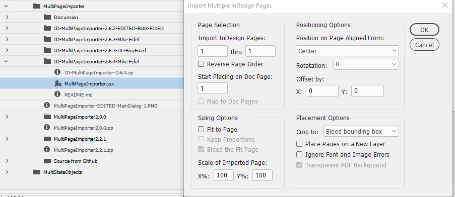

[2] Create a new document, page size is the same like the page sizes of your InDesign book documents, but there should be one difference if you export with bleed around your pages:
Setup this new document as a non-facing pages document with just one page.
[3] Place all PDF pages of step [1] by using the script MultiPageImporter so that all pages are placed automatically.
MultiPageImporter will add pages to your document if necessary. As you can see from this screenshot below you have various options like "Center" on a page etc.pp.:
Download MultiPageImporter originally written by Scott Zanelli, now curated by Mike Edel from:
https://github.com/mike-edel/ID-MultiPageImporter/releases
[4] Finally export from that new InDesign document.

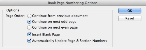

To get around this in the Book Panel check the book page numbering options in the book Panel sub menu
July 29, 2021
Thank you for that! Yes, we tried exactly that. It seems to be a page arrangement setting rather than a left/right issue as that did not solve the problem.Your layout example is exactly what we are working with. When it exports, it ends up like:BOOK
