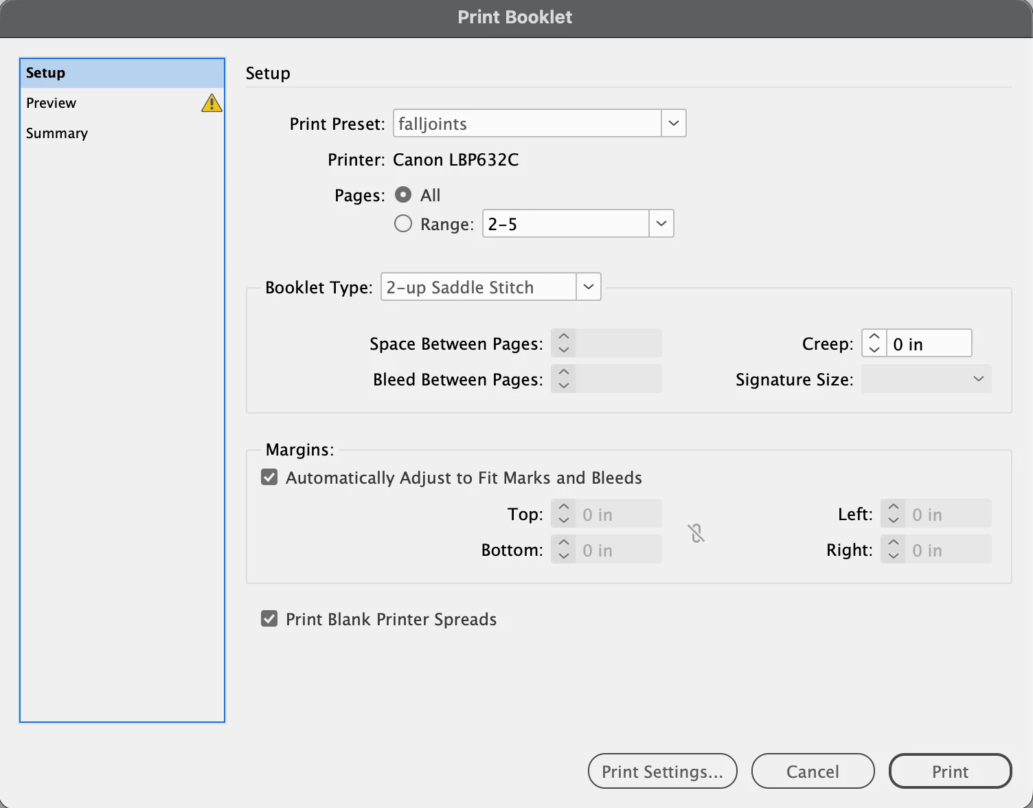

I’m trying to print a project as a booklet on InDesign. I’ve printed a few before that were successful (after some troubleshooting), but I’m currently having an issue I haven’t run into before:
When I test print the first four pages of my file to make sure the front and back are aligned, the front of what’s printed on the page is about 1/8” longer than the back. The front spread is 10” long and the back spread is 10 1/8” long.
In the InDesign file, the spreads are 12x9.5 inches, but I’m printing at 85% scale, so maybe that’s the issue? However, 100% scale is too big for my printer (I created the file before I realized I would be printing at home). I’ve also printed previous projects at different scales and it went fine, so not sure why it would stop working now.
The creep is set to 0 inches.
Any idea what could be causing this?
P.S. I’d rather not print from Acrobat. I was having major margin issues and could not get the pages to line up for the life of me (and yes, I adjusted the print position on my printer--that was not the issue). Since I’ve printed booklets successfully from InDesign before, I’d like to try to make it work again. If that’s the only option, though, I understand……...

    anomander29298064sl56
    May 9, 2026 3:45 PM UTC
    Hi, Harshika. Thank you for the reply and apologies for the late response.
    • I’m using InDesign 21.3
    • My OS is Tahoe 26.4.1
    • This issue is happening with all files
    • I’ve attached a screenshot of my print settings on a project that I was previously able to print double-sided as a booklet. I’ve also attached the print summary
    Please let me know if you need anything else from me.
    Abhishek Rao
    May 12, 2026 5:09 PM UTC
    Hi ​@anomander29298064sl56,
    Sorry to hear that you’re still experiencing this issue. Could you please try disabling “Print as Bitmap” under Print Settings > Advanced and then test the booklet printing again?
    Also, instead of scaling inside InDesign Print Booklet, please try exporting the booklet at 100% scale and then control the scaling either only in the printer driver or only in Acrobat, but not both simultaneously.
