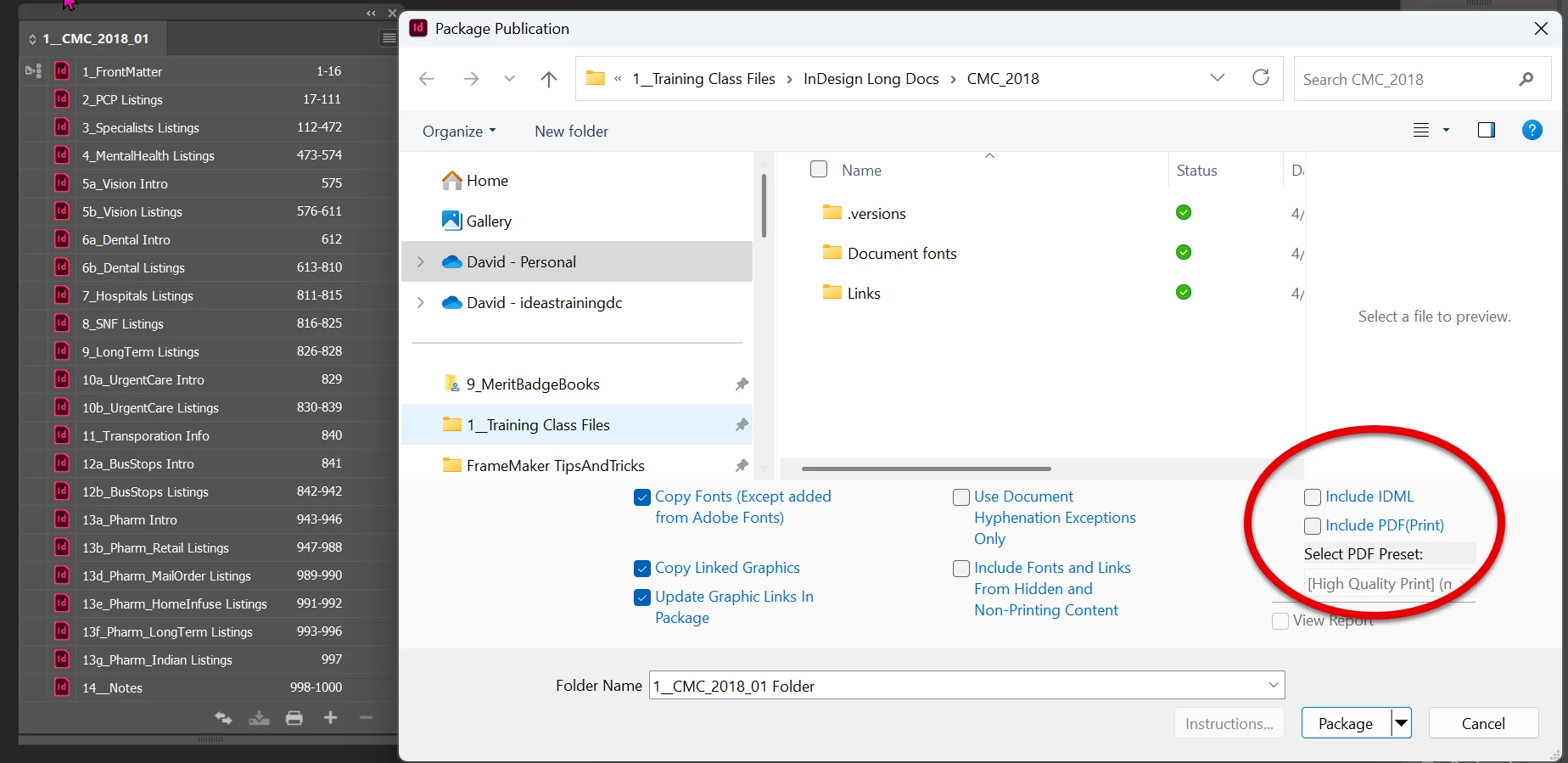

Did you try packaging the book? It will collect all the InDesign files (possibly reducing the file size during re-writing), copy all the graphics, and relink to the new files. Turn off the circled items to save time unless you need them.
IMPORTANT: This _copies_ the files--not move them--so you will still have the originals on your system. It's best to remove them or archive them so you won't accidently open the wrong files.
