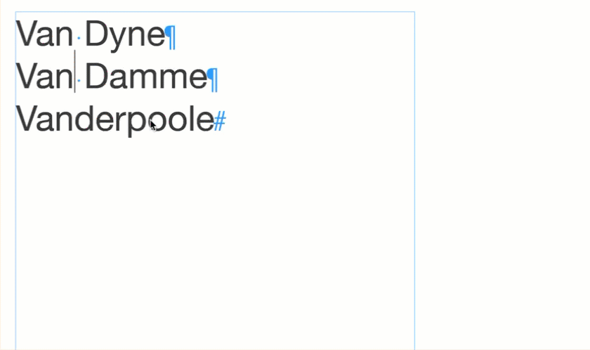

InDesign can't alphabetize proper names correctly.
For example, it lists Vanderpoole before Van Dyne. I had to put a nonbreaking space to keep Van Dyne out of the D section.

If you use the index then you should handle sort problems using the sort-order field (in the New Topic window). For some applications, see
https://creativepro.com/files/kahrel/indesign/index-fixes-sorting.html

Well, wait. These are two different features. Are you indexing, or sorting lists? If indexing, you want to fix the topic reference, otherwise you will have to fix the index after each update.
~Barb
Jan 24, 2025 9:39 PM UTC
True, but I can finish the index and then sort it with the sortparagraph function at the end.

Details help us help you faster. Are you using the script that comes with InDesign? If yes, did you try disabling Ignore Spaces?
~Barb
Jan 24, 2025 9:22 PM UTC
Thank you. This is very clear.
Jan 24, 2025 9:10 PM UTC
How are you alphabetizing, with the SortParagraphs script? When using this script, my test results work correctly.
Jan 24, 2025 9:18 PM UTC
I was just using the index generating function. Ah! It works. Thanks very much!
