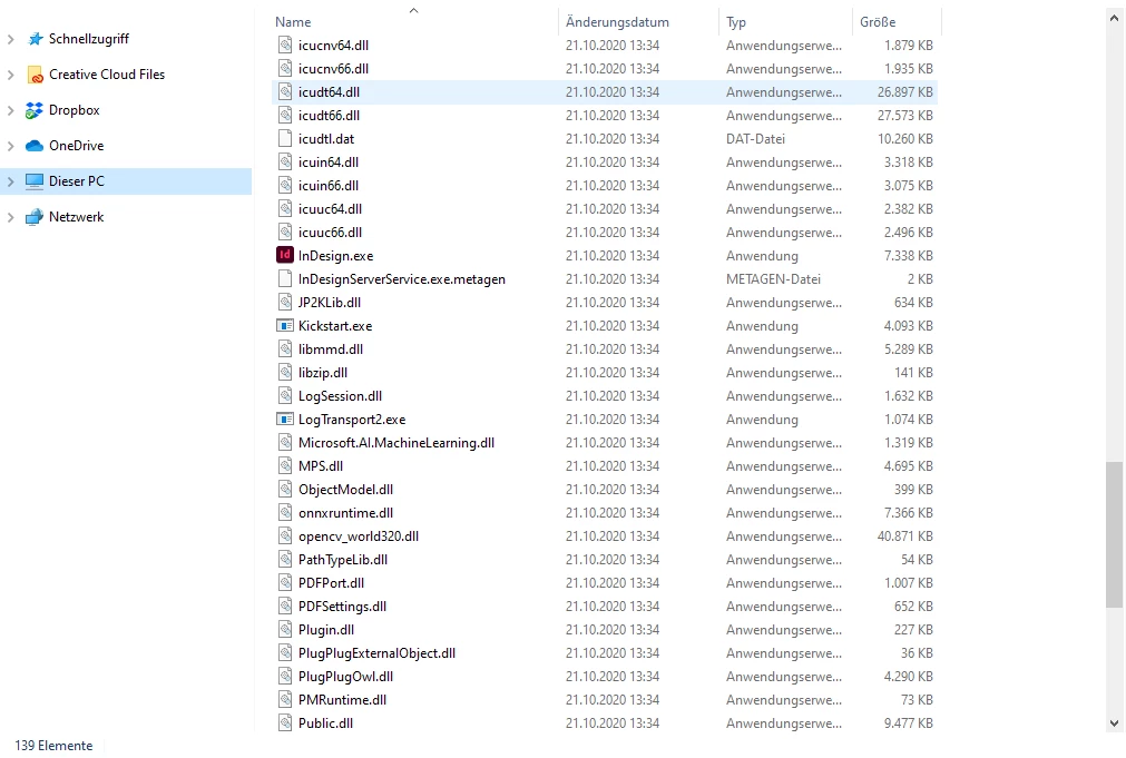

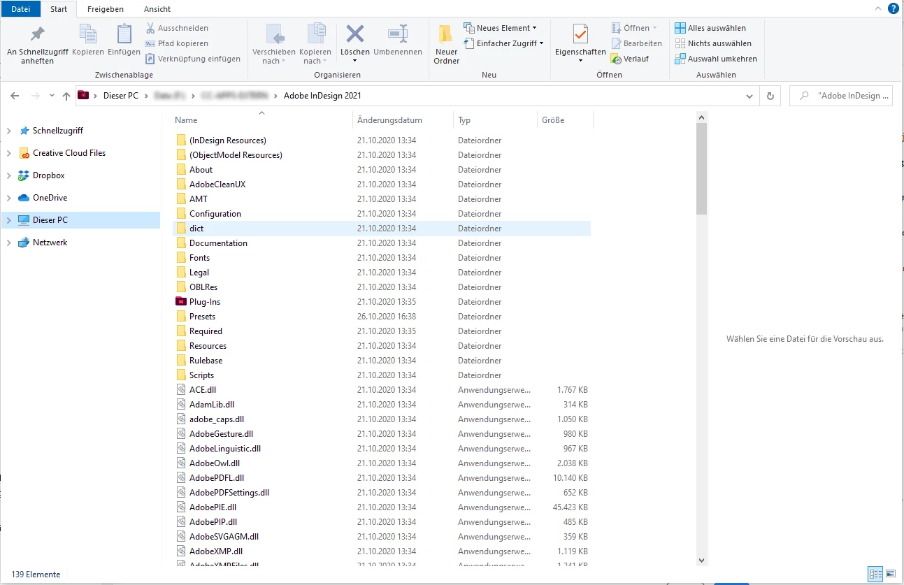

If you have access to your applications folder on your machine you should see something like I show in the screenshot below ( from my German Windows 10 machine ) :
As you can see a Presets folder is there and if you scroll down you see the InDesign.exe file:
