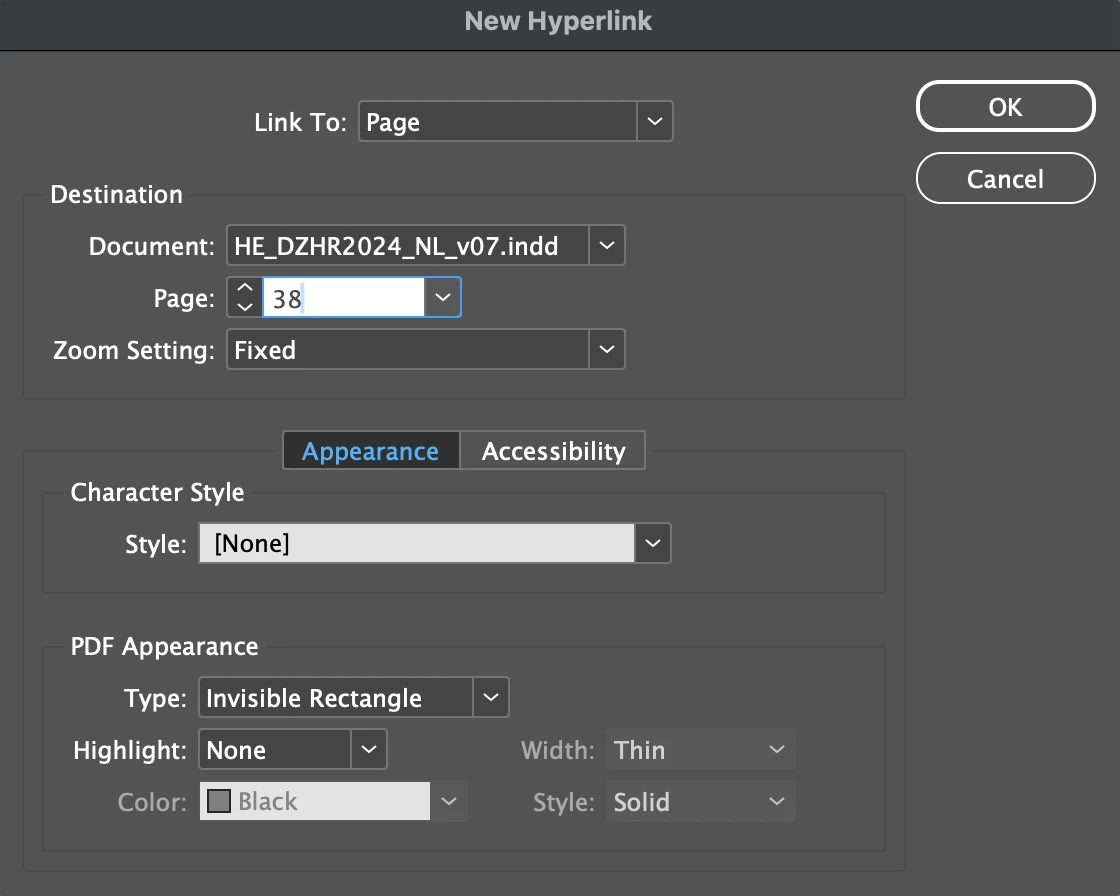

I also notice that sometimes links just are deleted: after correcting a page hyerlink, I then export the interactive PDF, and the links are there but still faulty sometimes (as described earlier). When I correct the links and then export the interactive PDF again, I see that previously installed links are just gone. Going back to the ID doc, the link has indeed been eliminated from the hyperlink panel all together and thus I have to make a new hyperlink. This obviously should never happen.

Attached is a screenshot of how I enter the links in the hyperlink panel.
