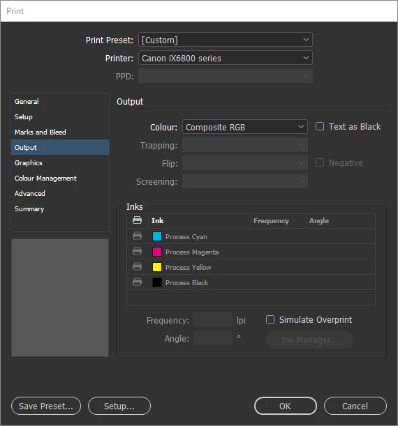

I had a problem in ID 2021 using PRINT BOOKLET to a Canon Pixma A3 printer. Some of my colored fonts were printing as black. I searched for hours for a solution. It was not easy to find, but I found the little bugger. I will share my experience to save headaches. One tip I found while trying to sort it out, is a print summary button you can click just before printing. In the long list I saw a line for Text as Black = on. So I looked for text as black in Indesign settings, it was not to be found. Text as black option to uncheck this awful little box came up only after PRINT BOOKLET and getting the Pixma printing options windows. I have attached a screen shot. Look for this window and uncheck Text as Black and your fonts will print as black where they are default text and color fonts where you have assigned custom color. Voila.
May 11, 2022
THANK YOU! It worked, was driving me nuts.

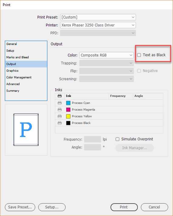

BobLevine
October 25, 2017
This screenshot should help:
AJtheWolfe
October 25, 2017
That was the first thing I checked, but the text as black is turned off.
