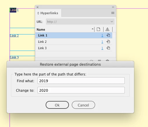

Here I wrote a quick and dirty script for you. Warning: not totally tested.
You have to type in the part of the file path which is different.

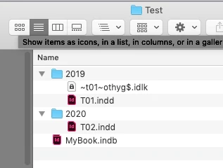

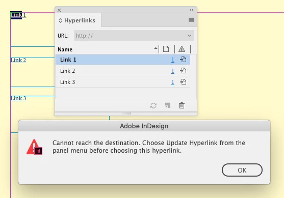

I tried to recreate your situation: the file T02.indd was moved from the 2019 to 2020 folder
Before — the destination is broken
After — the hyperlinks were fixed

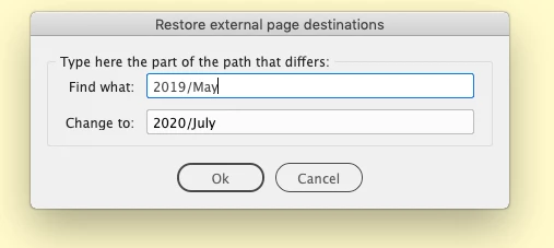

By the way, it also works with sub-folders. They should be separated by forward slash/ — like so:
Hope it helps!

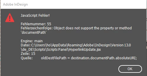

felix888
felix888Author
July 12, 2019
sorry - it doesn't work!
