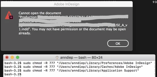

LangkusnoAuthor
Dec 5, 2019 5:14 AM UTC
Hi srishtib8795206,
Thanks for your reply,
i've tried what you have been suggested, but seems the issue still persist,
please see attached screenshots.
