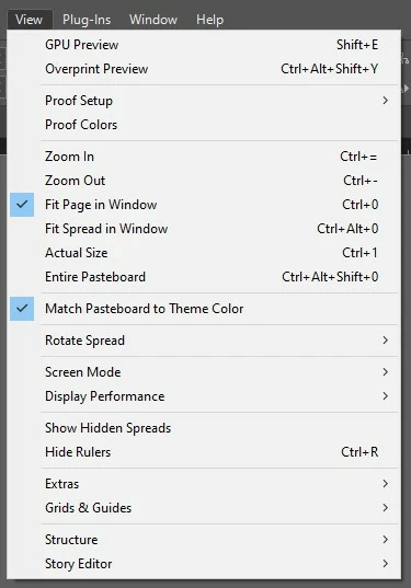

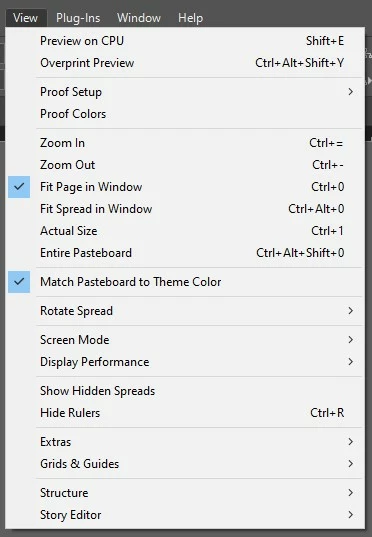

Oct 27, 2025 8:59 PM UTC
Update: I've figured out why its happening, but not how to stop it from happening by default.
Under View: GPU Preview - Preview on CPU toggles the Center Reference Point to show or not show.
When it shows GPU Preview, the Center Reference Point is shown. However, it is not the default currently.
My coworker does not have this setting available (Compatible GPU and Monitor not detected).

Hi @David27007364tk1q,
Thanks for sharing this update. I tested this on my end with InDesign 21.0 on Windows 11, and the center reference point appears consistently in CPU Preview. On GPU Preview, it shows up when the object is stable but not while moving, which is different from your observation.
I'd suggest isolating the issue further by running InDesign in Safe Mode to rule out any third-party interference. You can follow the steps here: Start your PC in Safe Mode.
Additionally, please test this on a system that isn't connected to your company domain, if possible, to see if any enterprise policies might be affecting the display behavior. If you have InDesign installed on a personal computer, testing there could help confirm this.
Regarding the 'Compatible GPU and Monitor not detected' message, it might appear if the monitor resolution is below the supported threshold. GPU features in InDesign require a monitor with a resolution higher than 2K. You can refer to this article for more details: GPU Performance in InDesign.
Looking forward to hearing your observations after these tests.

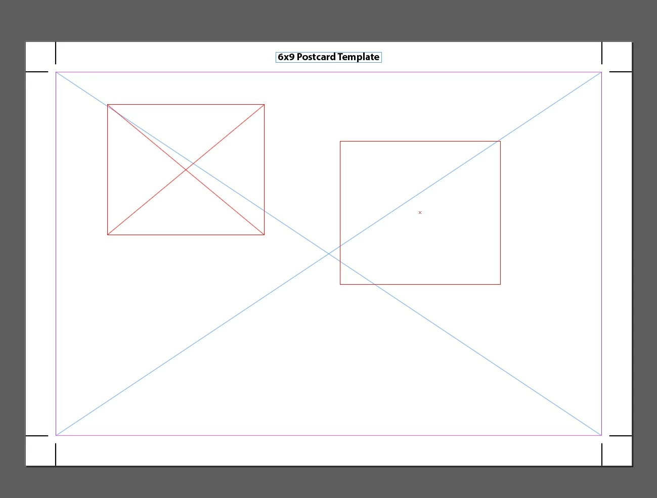

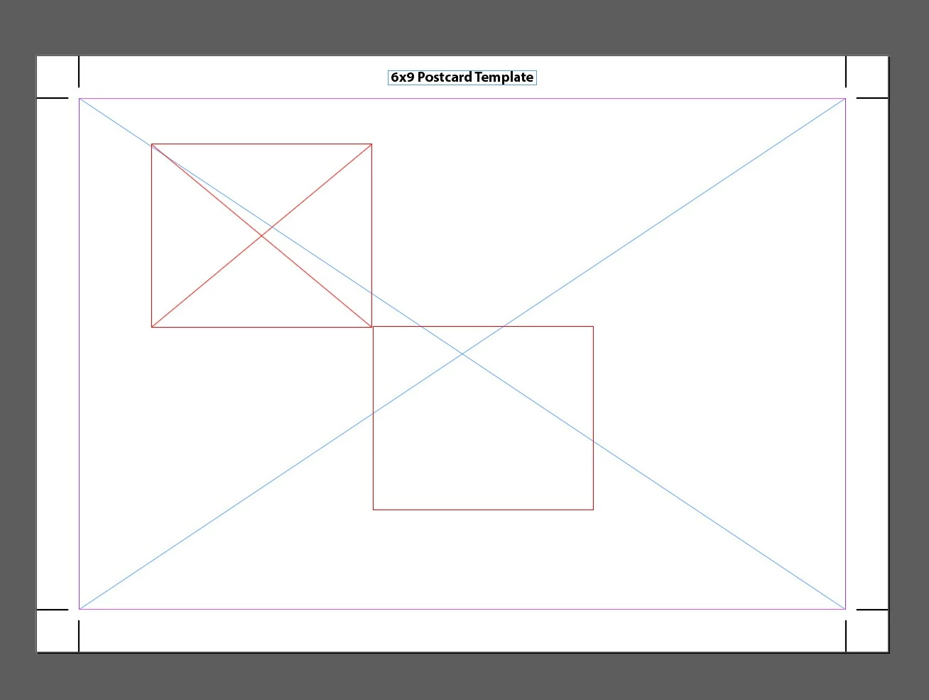

Sep 15, 2025 9:21 PM UTC
 This is how it looks when I drag around an object. There is no center reference point. The red box on the right is being dragged around for placement.
 This is how it used to look when dragging around objects (this image was taken when creating a new box with Rectangle Frame Tool. You can see the center reference point. The red box on the right is being created.
It is not possible to switch to an earlier version as that is controlled by IT.
