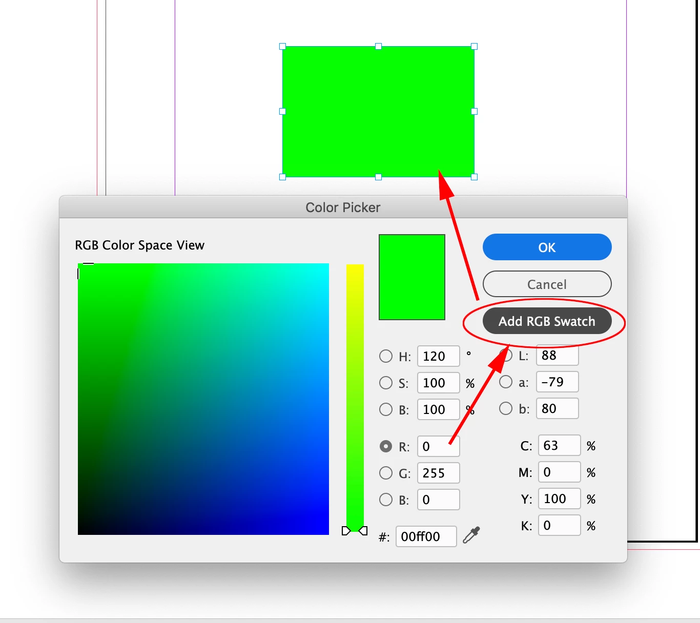

I'm having issues with InDesign displaying the colors that I choose.  I first discovered this when I placed images (jpeg, png, pdf, psd- tried them all) into InDesign and the color was different.  However, even if I simply draw a rectangle and try to choose the fill color InDesign changes my choice to a more faded out version.  For example, if I choose #00ff00 from the Color Picker it will automatically change it to #68bd45.  It does this with all colors, not just greens.  Pretty much any color I choose it will automatically change it.  If I choose a color closer to the middle of the Color Picker it changes the color # but not as drastically.  If I choose something near the edges it changes it drastically.  I have no idea what to do.  Thanks for any advice.
InDesign’s Color Picker is context sensitive. The color you pick depends on where your cursor is in the dialog. You can see it in @Brad @ Roaring Mouse’s capture where he’s getting Add CMYK Swatch when his cursor is in the C field and an Add RGB Swatch when the cursor is in the RGB R field. Hex is an RGB notation, so to choose #00FF00 your cursor has to be in one of the RGB fields with Add RGB Swatch showing:
When placing images make sure to embed a color profile when you save them.

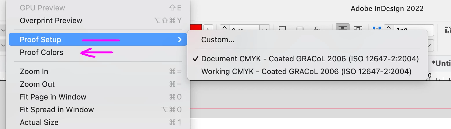

If your end goal is to print this document, you have to remember RGB/HEX colours are only for the screen. They do not translate to a print space. Normally, InDesign assumes this is a document for print, so whatever you type into the HEX box may be converted to the CMYK values at right (The clue is it will say "Add CMYK swatch" above). This colour is the closest you will expect to be able to print based on your Color Settings, which truthfully, is a good thing for you to know. However, if you click in any of the RGB inputs, you will see "add RGB swatch". This will give you the color you want for your object on the screen, but you still won't be able to print it.
Some colours in the RGB space are easier to match in print, so, yes, depending on where you click in the color picker, there will be more/less difference.
You can then turn Proof Colors on or off (under View) to show the difference between RGB and whatever CMYK space you have set (Mine is GRACOL; yours may be U.S. Web Coated or something similar)
