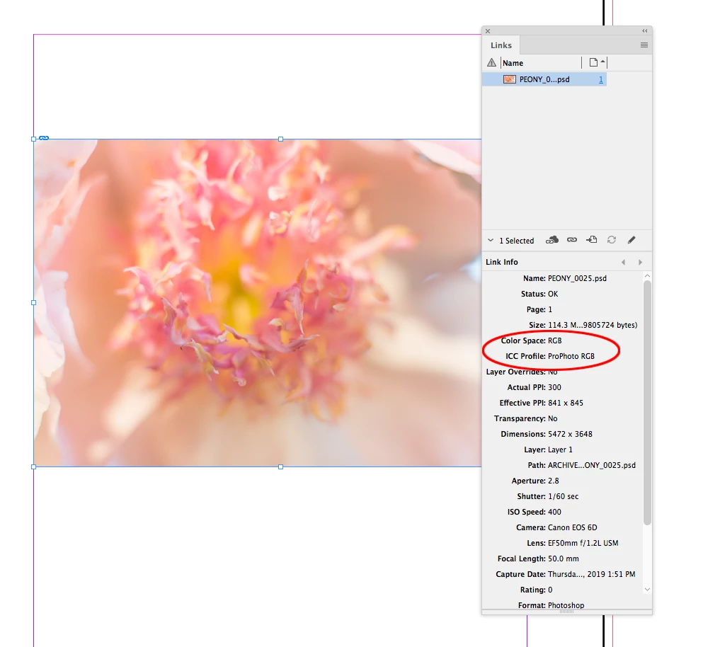

Keep in mind that your application Color Settings don’t usually color manage existing documents—it is the assigned profiles that color manage an existing document's colors and swatches, which you can check via Edit>Assign Profiles. Also, you have to use the Link Info panel to check the color space and profile assignment for an image, which could be anything—again Color Settings wouldn't normally color manage a placed link.

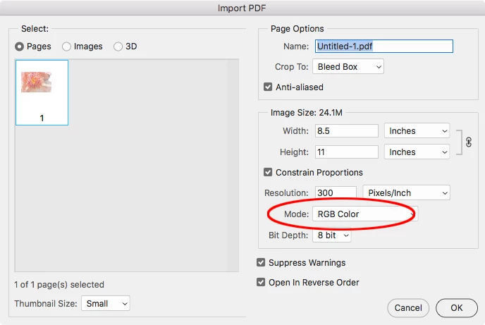

When you say you are opening the image, are you extracting the image from the PDF in Acrobat, or opening the PDF from Photoshop? If it is the latter, that would not be reliable because there could be a color conversion during the Photoshop open.

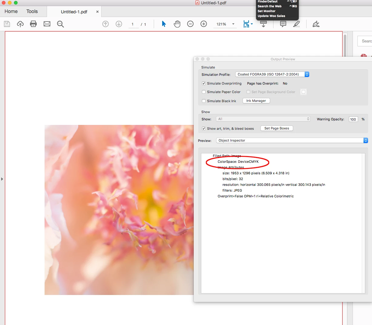

In Acrobat’s Output Preview use Object Inspector to get an image's detailed info—Separations doesn't give you the actual color space of an image. The default Press Quality preset will convert RGB images to the document CMYK profile and not include any profiles because of its Profile Inclusion Policy.
Here I exported a page with a ProPhoto RGB image to Press Quality, and when I click the image, Acrobat‘s Object Inspector shows the the image has been correctly converted to CMYK with no profile (DeviceCMYK):
With Object Inspector you can click on any page item to get its true color space and profile.

If i open output preview and select object inspector and click on the image it says "colorSpace DeviceCMYK"

I am opening the images from the the pdf by right clicking on the image and opening in photoshop.
So why does my CMYK image open in RGB in Photoshop, is it CMYK in the pdf or RGB?
Photoshop doesn't tell you anything about the native color mode of the images on a PDF page, the color mode you get for the imported page is whatever you choose in the Photoshop Import PDF dialog Mode dropdown. A PDF can have a mix of objects with different color spaces on the same page, but a Photoshop document is limited to a single color space, so there has to be a conversion choice:

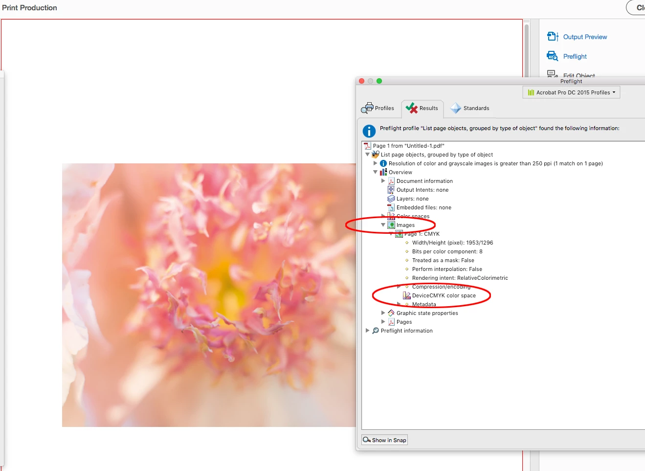

The Object Inspector is accurate—your image is CMYK. Another way to check is with Preflight, here I'm using the List page Objects to get the page info.
