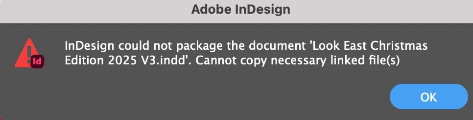

Is anyone having an issue with packaging files. I keep getting this error since i updated to the latest version. I have tryed packaging to my desktop but I still get the same issue865759i647FE8FA800E2323.jpg

Peter Spier
Nov 24, 2025 9:52 AM UTC
Mac? Sounds like you need to give InDesign full access permission.
Nov 25, 2025 2:14 AM UTC
Already done. Still not working

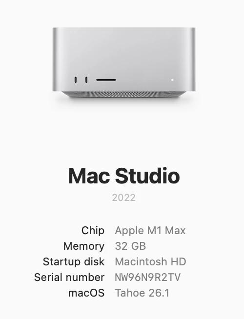

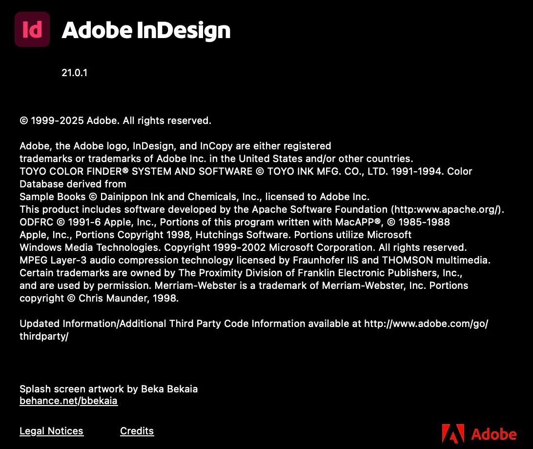

Please see attached links to the OS and the Indesign Version. Our IT team has worked on all the troubleshooting options available and have concluded that this is an adobe issue with the new MAC OS. I need a work around or a fix for this asap.
leo.r
Nov 25, 2025 3:39 AM UTC
quote
By @Communications5CCF
I assume your links are on a network. If so, then there's a known issue with InDesign on Tahoe: links cannot be packaged on Tahoe when the links are on a server. There were several threads about this issue recently.
Updating to Tahoe at this point without thoroughly testing your workflows was a mistake. This OS is just too new. Try to revert to Sequoia until this issue is fixed.
