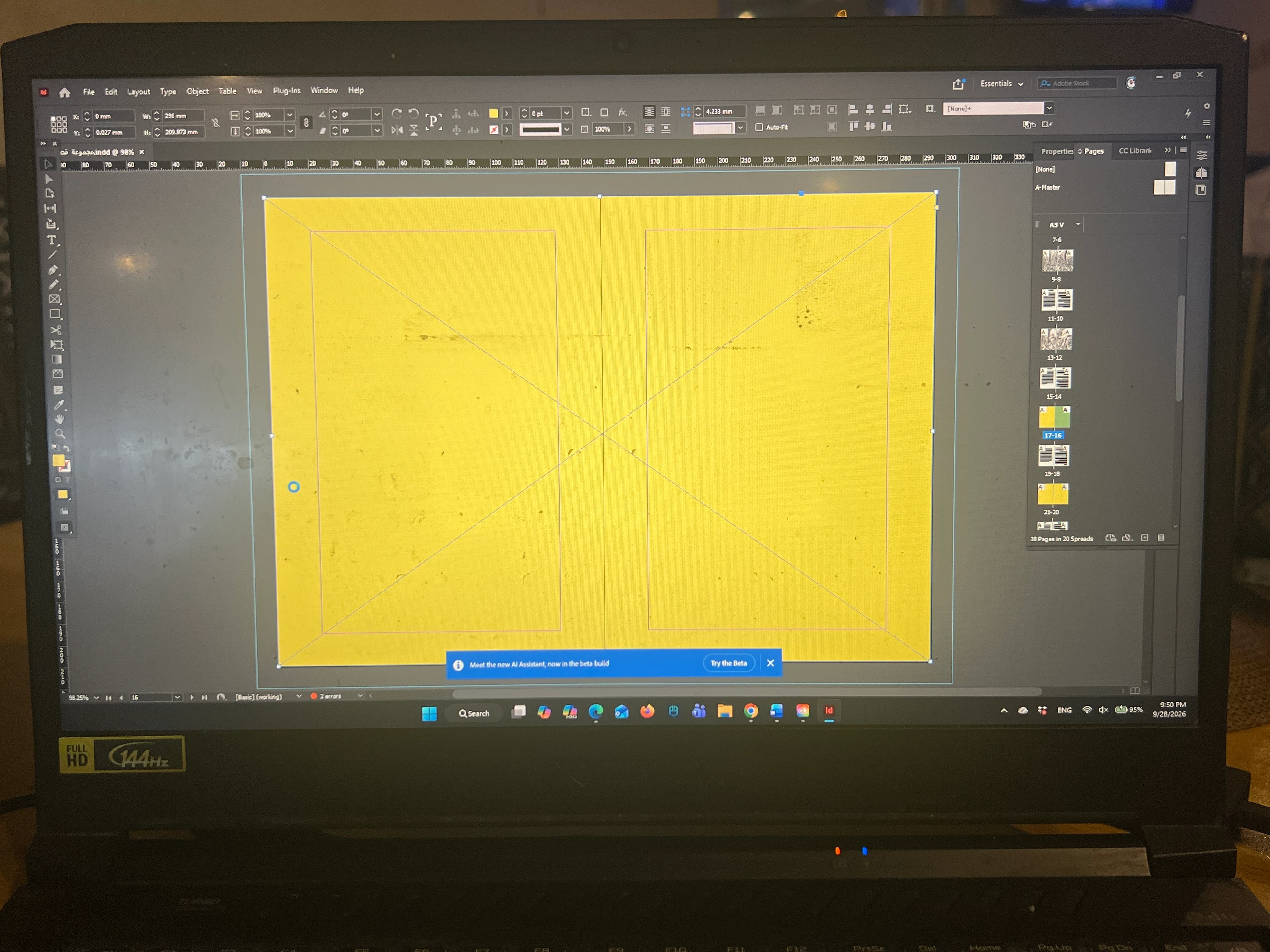

I was attempting to do some basic tasks with Flex Layout in InDesign PC. After about a half-dozen things were tried InDesign completely froze, the process had to be stopped and the program re-launched. This is 100% repeatable behavior, whether with an existing file open or with a new file open. Everything else with ID is fine, just whenever I try to use Flex.
I can work around this by never using it (I never did before), but since there’s a risk of document corruption when I force-close I.D. I’m wondering what’s going on.

    The document is proprietary, but the workflow was extremely simple. Four stop signs that I wanted to equally space within a square. This is the kind of thing I do with distribute and align tools and for a simple task like that it serves me well. I just wanted to see if Flex could do it more easily. After the 8th or 9th crash recovery I copied the stop sign graphics to a new document and experienced the same issue.

    Windows 11, InDesign 21.3 x64, Ryzen 7 CPU, 128 GB of RAM, two 2TB nVME drives, Nvidia GeForce RTX 3060 with 4GB. No third party plug-ins installed. I always update the OS and apps as soon as updates are announced, so consider it the latest and greatest.
    I guess I should just close the case since I’m not going through massive troubleshooting steps for a feature I’ve never used before and probably never will again. While it could be helpful in certain projects, that juice ain’t worth the squeeze. I was more curious if I was the only person reporting this issue. I have the system running exactly as I need it to run, and the 700 Mb InDesign project that is my life’s work is open 24/7 for whenever inspiration hits for changes or additions.
