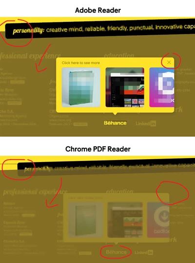

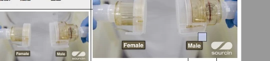

June 2021. This problem canno't be solved. I've try all this fixes for hours and hours. What Steve is suggesting, helps a bit, but the problem resides in the final PDF. If you open the file in Adobe Reader, it works great, but when you open the file in Chrome and Edge PDF reader, the result is a mess, because all buttons and form show in reverse stack order! InDesign have a terrible bug problem that needs to be fixed. Please take a look at this screen capture:

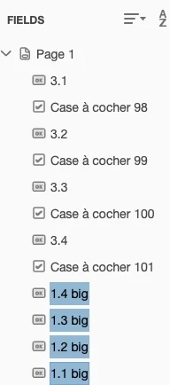

I had a project where, when we roll over on thumbnail, we should see a bigger version of picture.
But it turns out that the tick boxes are over the picture, which its wrong.
So if you open the PDF in Acrobat and go for Prepare Form tool, you have all interactive objects shown as layers. SO I moved all layers related to big picture on the bottom of the list:
And now it shows me correctly:
I know this is not the solution, but I hope it can help you guys.

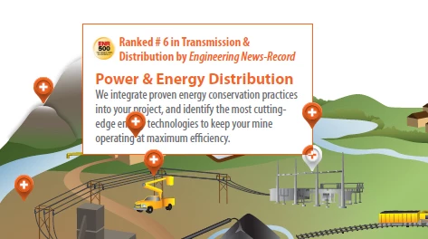

No answer for you, but the same thing is happening for me! Mine is like a map with pop-up captions on it. The captions (which are hidden-until-triggered, actionless buttons) are on a layer ABOVE the marker buttons in InDesign, but Acrobat still displays the markers above the captions. I even tried removing all of the actions from the buttons in InDesign and adding them in Acrobat, but it still didn't work. Here's a screenshot from Acrobat of the caption showing up behind the orange markers instead of on top of them:
Also, you can see that the corner of the caption is disabling the rollover state on the marker - it should be covering up that little orange piece. What is going on!?!
Document Geek
Document GeekCommunity ExpertCorrect answer
May 21, 2013
It seems that for interactive elements, the stacking order is determined by the order in which the objects are converted to buttons. Try removing not just the actions, but turning them back into objects. Or, convert them into buttons in the oppsite order than you did the first time. It's maddening, but it should work. Apparently, button creation order trumps actual stacking order. Weird!
May 21, 2013
YAY!! It was the stacking order! And that seems to have solved the rollover transparency issue too. I will just have to undo/redo all of them now, but I'm so glad there's a solution. Thanks so much!! I will definitely remember that for the next project.

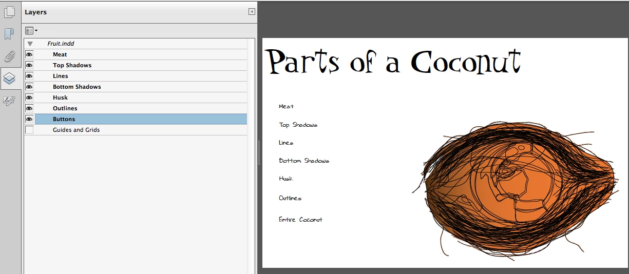

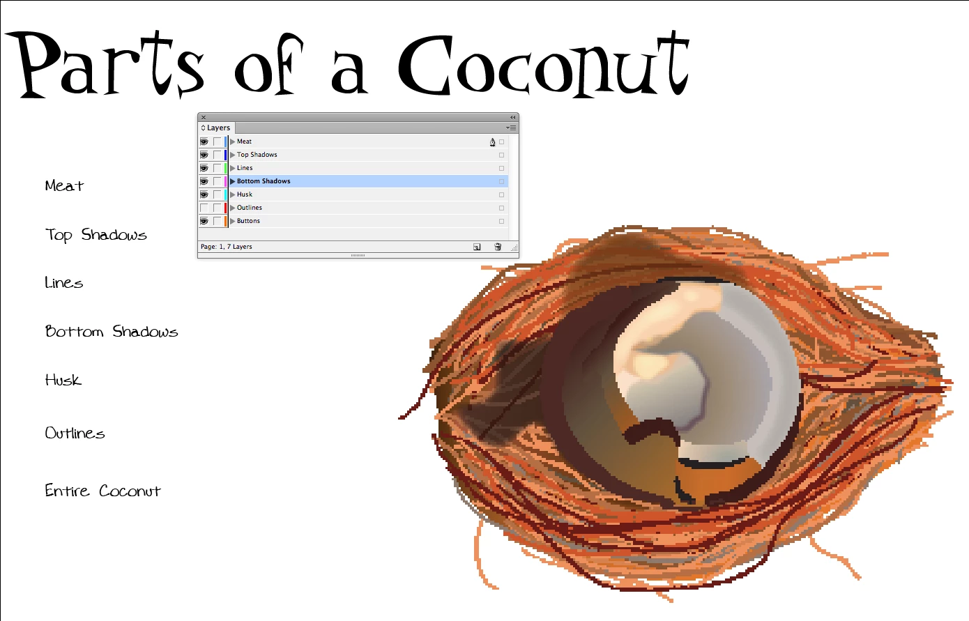

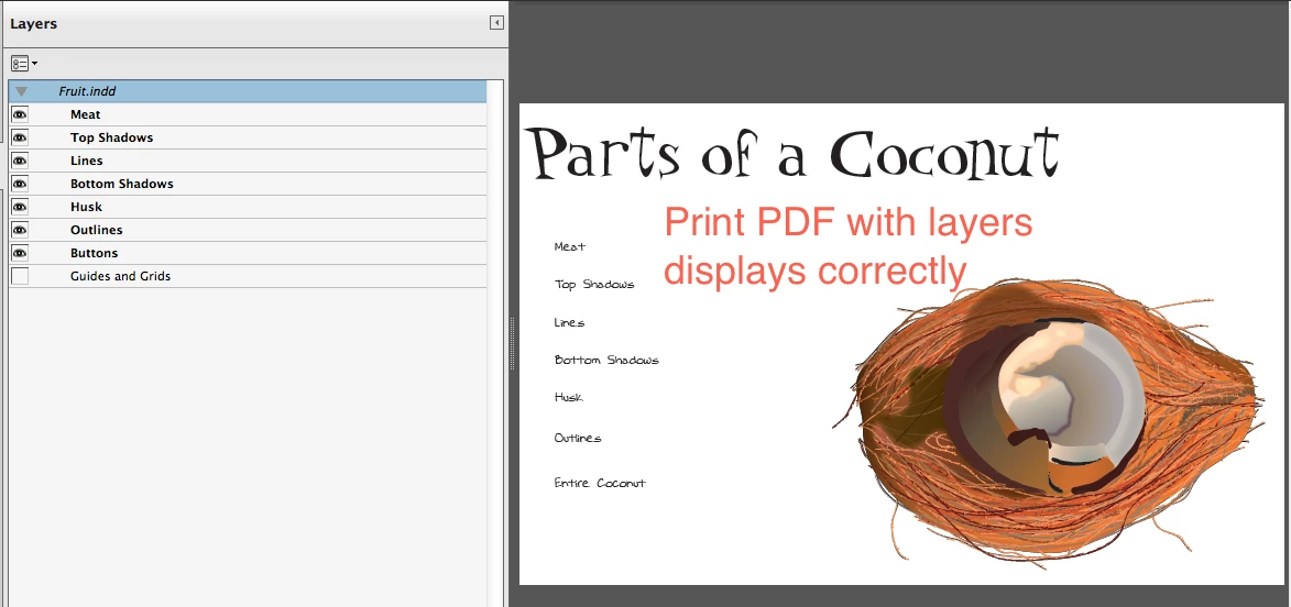

I am having the same problem. Here are my screenshots. In Acrbat 10, in the layers pane, the layers names show up correctly, but in the actual graphics of the PDF, the layers are displayed in the reverse order.
