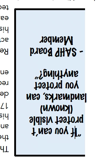

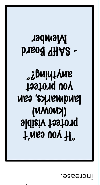

Rather strange thing keeps happening. I am simply placing a PDF into InDesign so I can print with a bleed. The first time worked great. I made a couple text changes to the PDF in Adobe Acrobat. I deleted the old vesion of the PDF and did File - Place to insert the new. It looks great in InDesign and I double checked to make sure it is within all margins. However, when I export to a PDF it randomly cut off one of the graphics. Seems like a gliche. Anyone have experience or ideas to try?
Screen shot of what happens when I export to PDF and what I see in InDesign.
