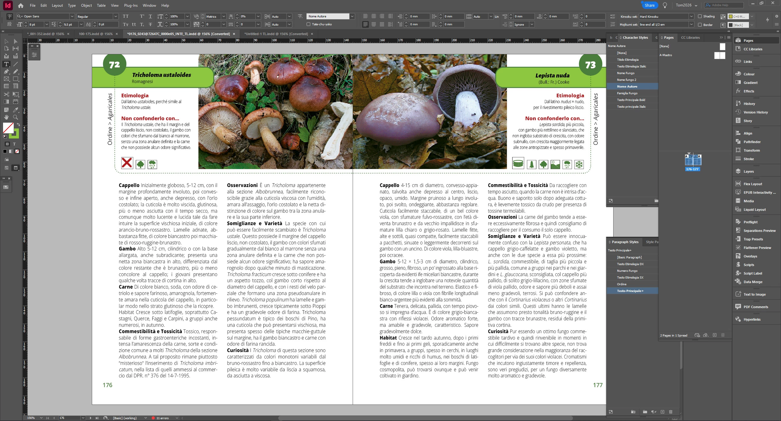

I'm having a new problem with the latest version of InDesign 21.0.2 x64.

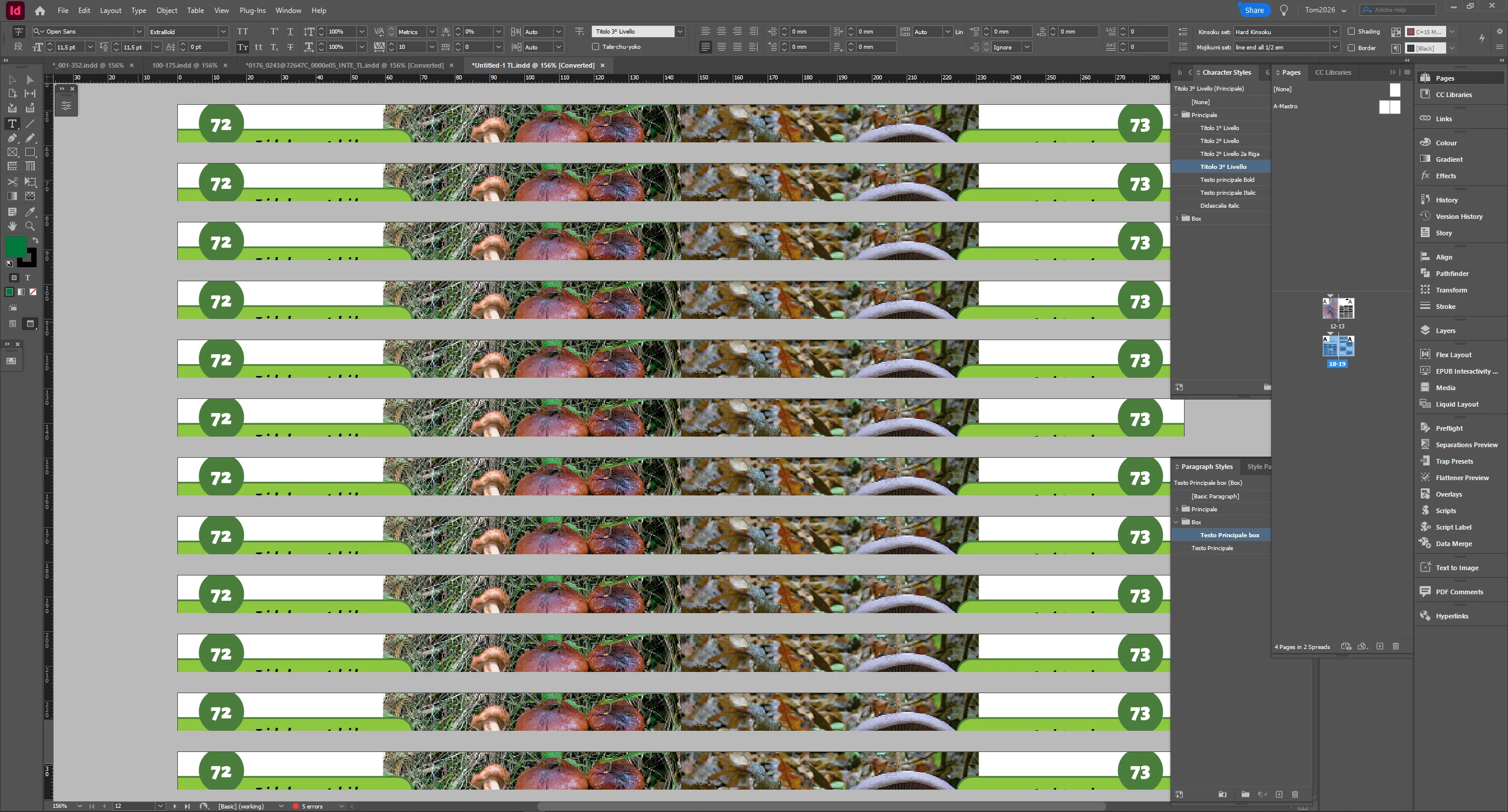

When I scroll with the mouse wheel, sometimes the page becomes unreadable, with a "comet effect" that prevents the page from being displayed correctly.
Attached are two screenshots of the "normal" and "comet effect" pages.

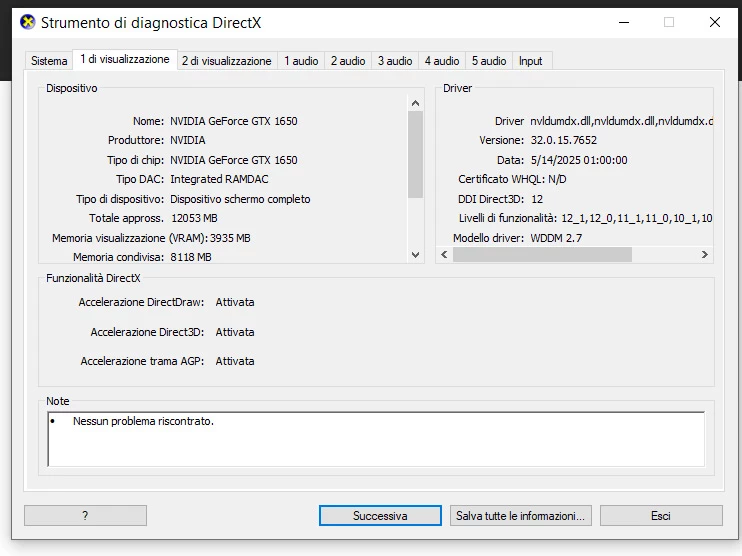

see the
attached screenshot for more information on the NVIDA
Thanks
