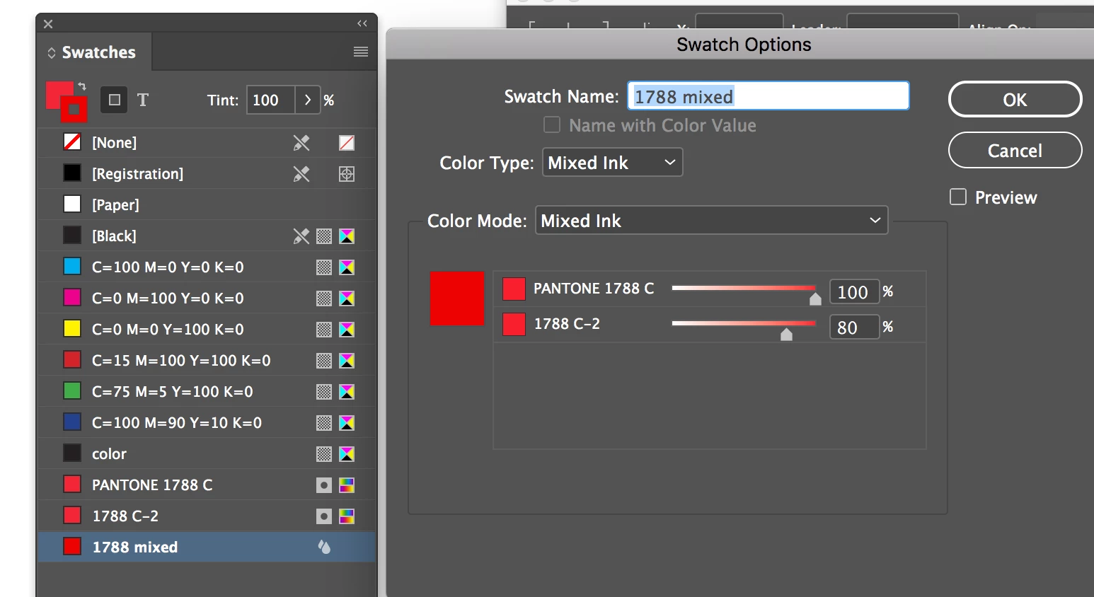

You can define the mixed ink as 100% of the first ink, and then 80% (or your chosen screen percenttage) of the second named ink.

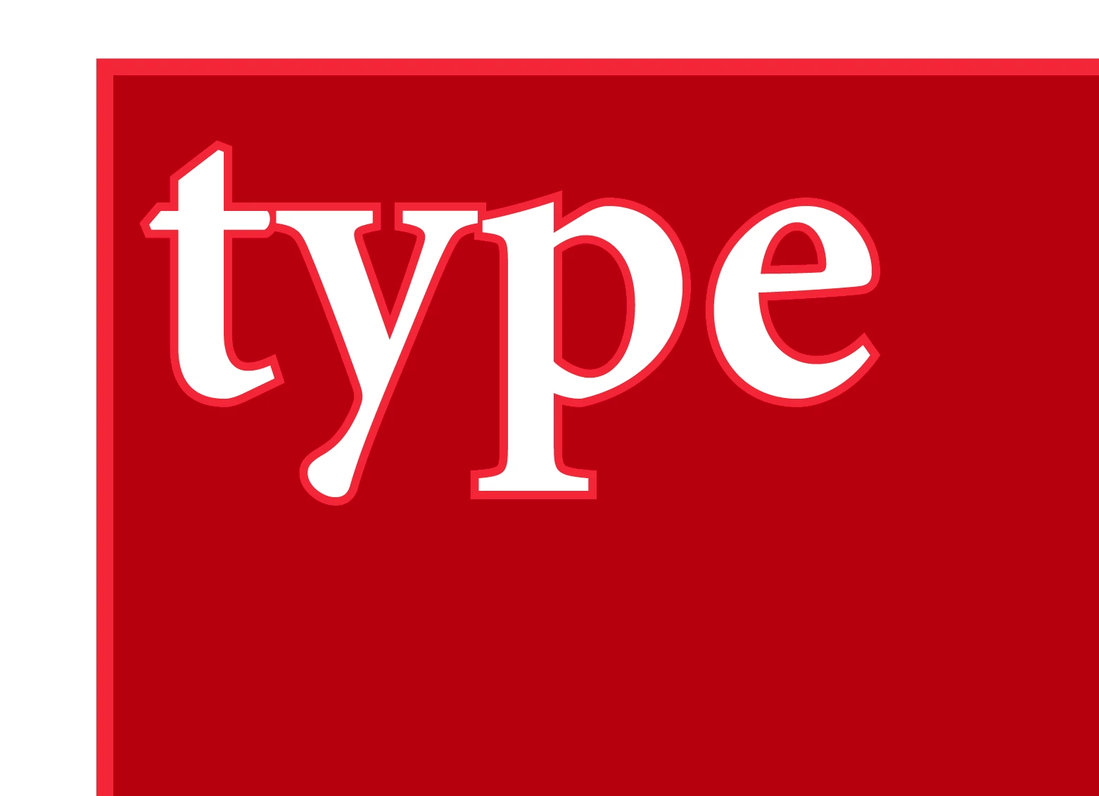

The cutting back for the edges and for text could be done by adding a stroke of just the first ink. Like this:
(The mixed ink shows on screen as darker, the single hit shows lighter)
