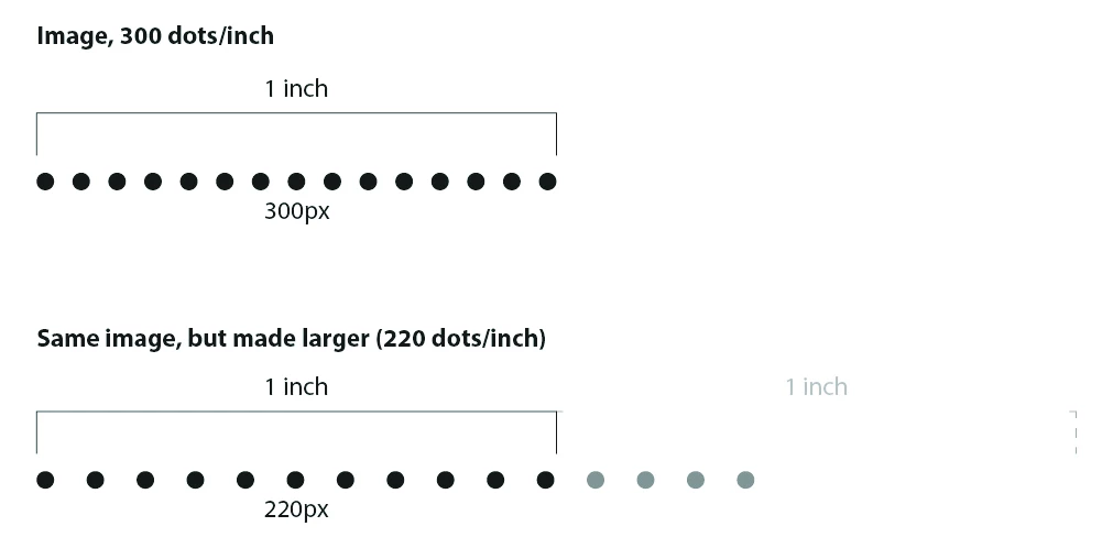

Hey, just an extra explanation to make this a bit more clear without all the numbers 😛 , I created an image for you:
When you make an image larger in InDesign, the resolution will go down (like the image below). When you make it smaller, it'll place the pixels (or dots) closer to each other. The resolution will go up. So InDesign itself doesn't change the image DPI.
By the way, if you notice the resolution changes in your PDF, make sure your you don't downgrade the pixels in the PDF Export menu, in the compression section.

InDesign doesn't do it, you do. And, it's not a "downgrade". In fact it's mathematical proof that the image itself is unchanged.
The simple math: If you place an image that is, say, 5" x 5" @300ppi (not DPI), then increase its phyiscal dimensions on your page by 10% to 5.5" x 5.5", the effective resolution (that is, the output resolution of a 5" x 5" image scaled, without resampling, to 5.5" x 5.5") is affected inversely by that same factor of 10% and falls to 270ppi. The same holds true in the other direction too. If you reduce the physical dimensions of that same 5" x 5" image down 10% to 4.5" x 4.5" the effective resolution will increase 10% to 333.333ppi.

Hey there, Yes the dpi will downgrade if you enlarge the image size in InDesign than its actual size.

Yes, if you resize the image -- check the Effective Resolution. 270PPI will be fine for printing.
