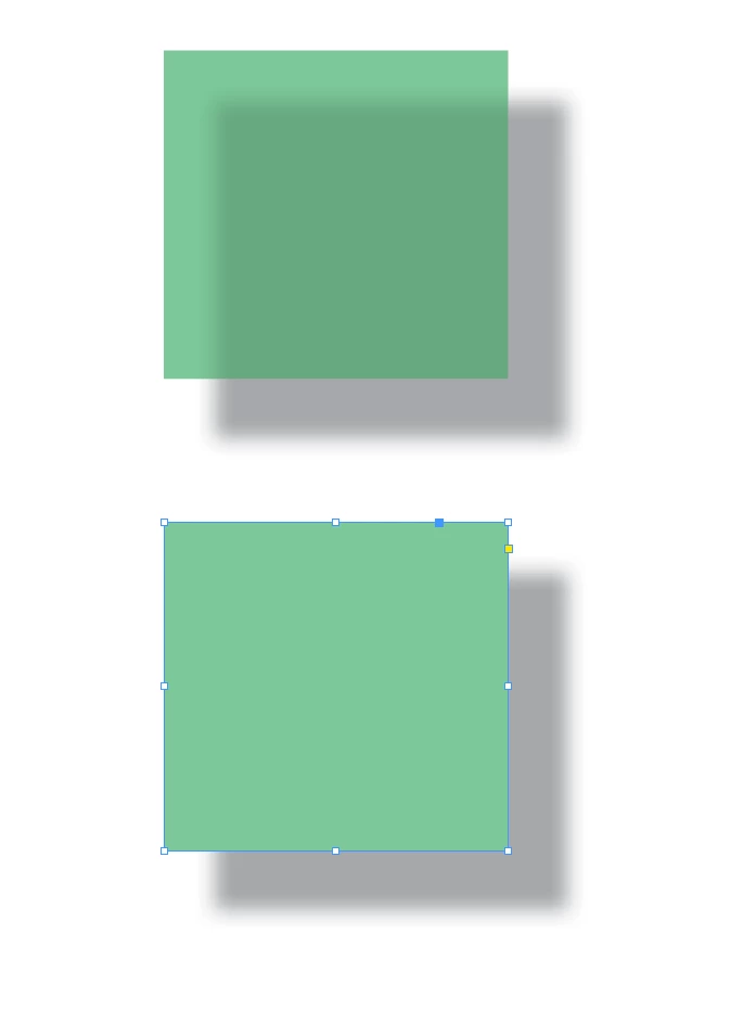

    It was rather annoying that it is incorporated into InDesign but causes problems on press. I never really understood what it does or how it causes the problem
    It might be needed if the object with the shadow is also transparent, something like this where the bottom version is set to knockout:
    Whenever you use transparency you have to consider where it will get flattened and if the output device is capable of correctly handling the transparency. What Export preset did you use?
