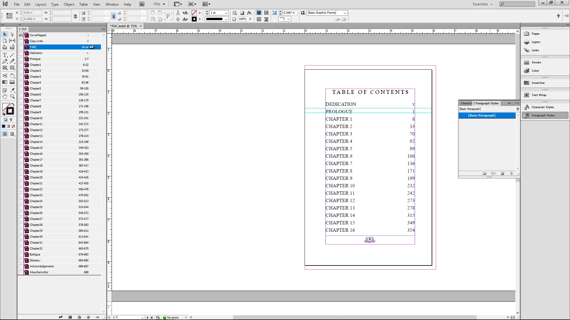

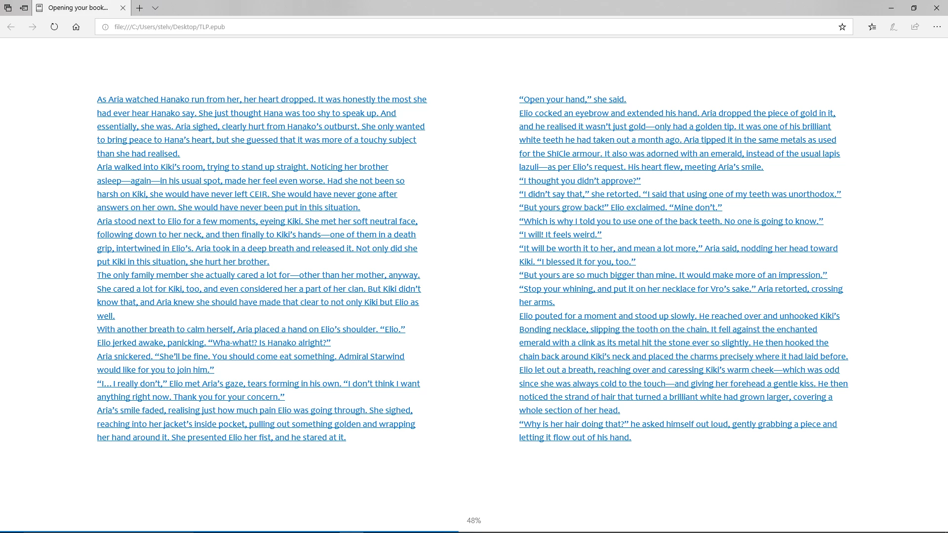

So, apparently, InDesign hates life and wants to put my WHOLE book into the TOC. It isn’t designed or set up that way and I cannot, for the life of me, figure what in the heck is wrong with it. I’ve tried so many things and good ol’ google isn’t any help either.
May I ask for some pointers and help to set me toward the right direction? I’m at my wit’s end, as I’ve had this issue the whole week with no progress. Attached are screenshots, if that helps.
The top is how I have it set up in InDesign and the bottom is how it is viewing in the ePub. I'm working in CS6.

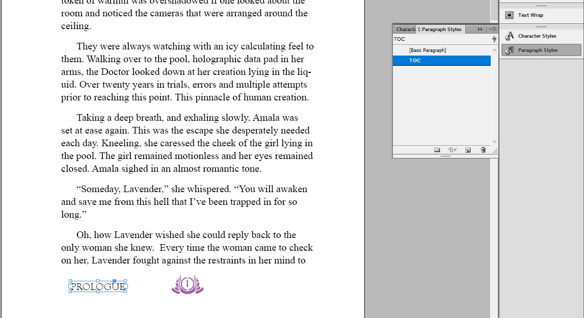

Actually, I DO have paragraph styles on all of my chapters. They're in their files set on a little piece of text on the bottom of the beginning of each chapter:

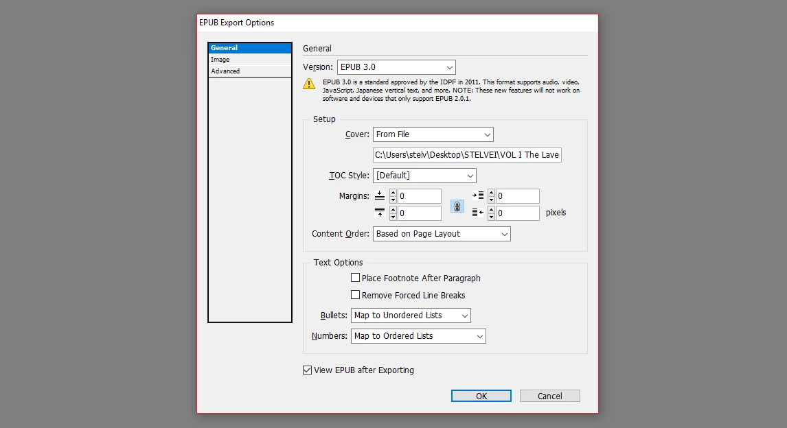

I'm actually unsure where I can see Reflowable text or FXL. When I export it, I choose Version 3.0 as most tutorials say to do.
